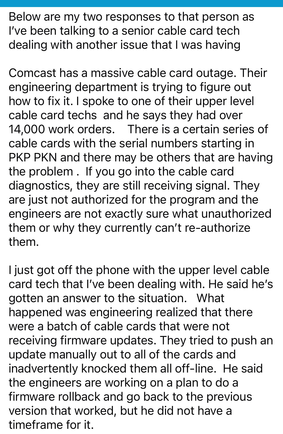

here’s an interesting comment that may explain this, quoted in a similarly-themed, current thread in the TiVo forum:
https://www.tivocommunity.com/posts/12935653/
Who knows, but I’m skeptical they’ll ‘fix’ it. Either way, no access now so I need another solution. I’ve decided to move on. I hope for those holding out that they fix it.
