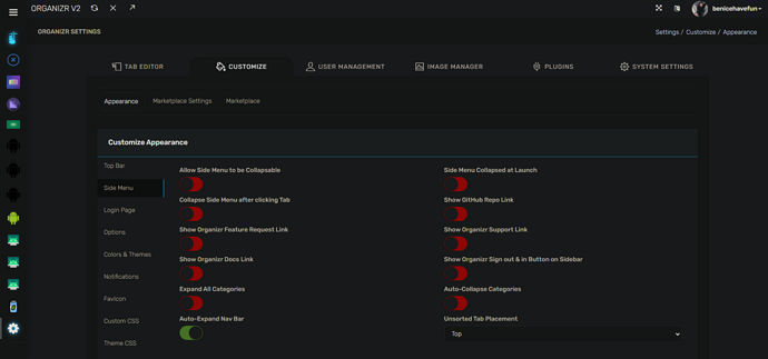

Also, I typically turn off most of the admin side menu icons, except for Settings. Here's where to go to do that:

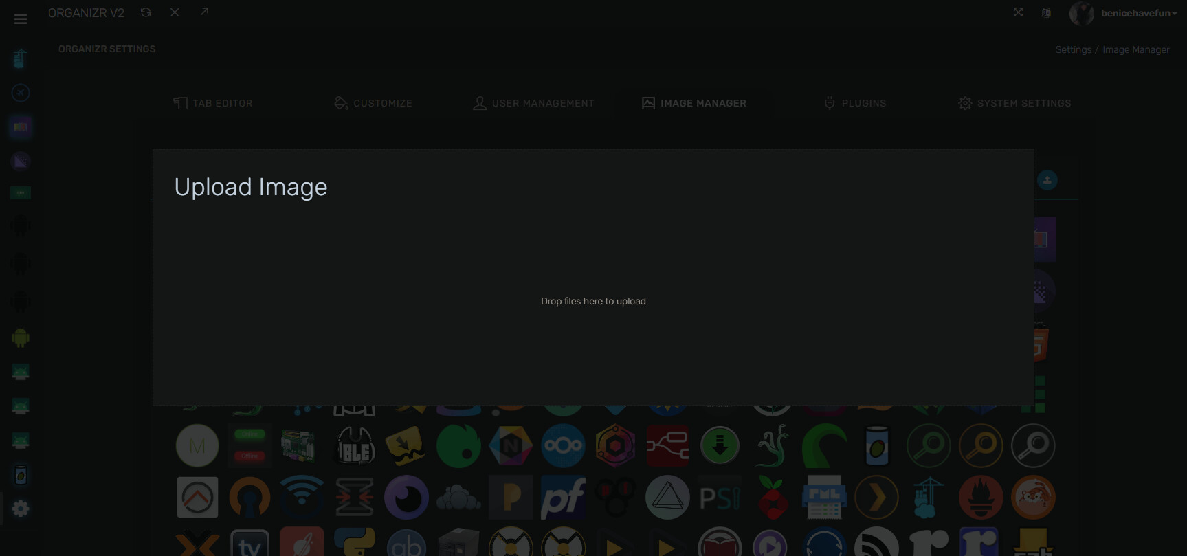

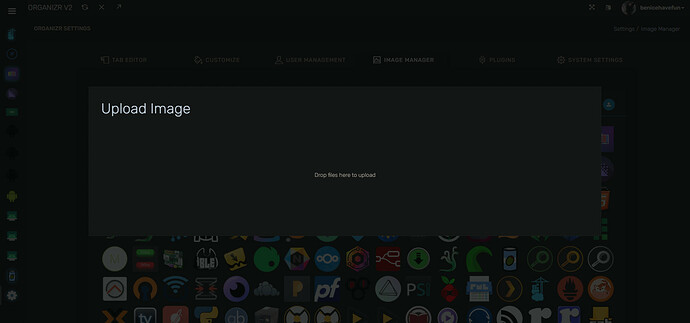

Thanks for the icons. I'm confused about where you put them and how you reference them in the tab editor. Could you explain please?
Use the Image Manager, and drag and drop the images. Make sure you give them a good name, as that name is what's used when you assign the icon in the Tab Editor. For example, name the Channels DVR icon channels.png:
You make it looks so easy! Thanks, that works.
Cool, good to know! I was just copying the PNGs I wanted to use into the organizr/www/organizr/plugins/images/tabs directory, which also worked fine.
