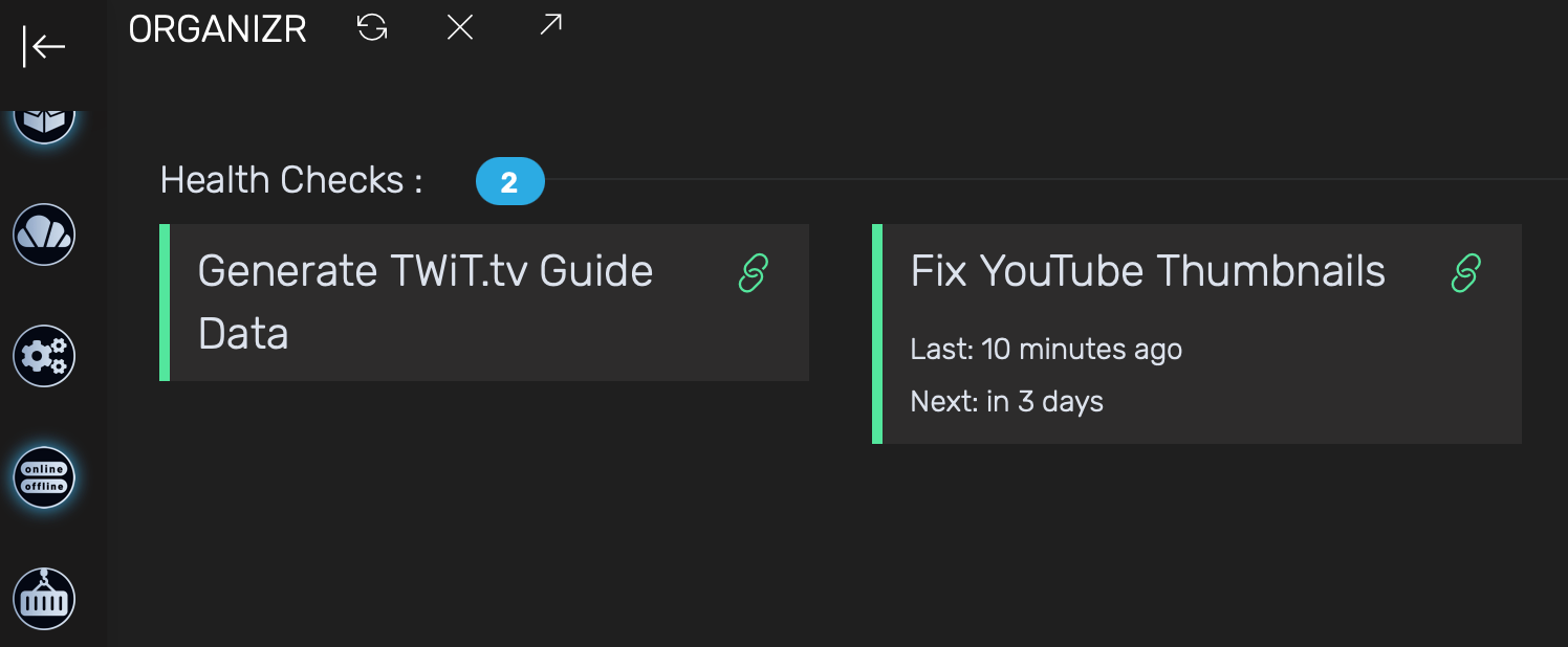

I also like the Healthchecks.io plugin, I got it integrated into an Organizr "home page:"
Nice find! I didn't realize that HEALTHCHECKS was "our" healthchecks.io. Sweet.
Ha! And I'd figured you chose it specifically because of its slick integration with Organizr. :wink:

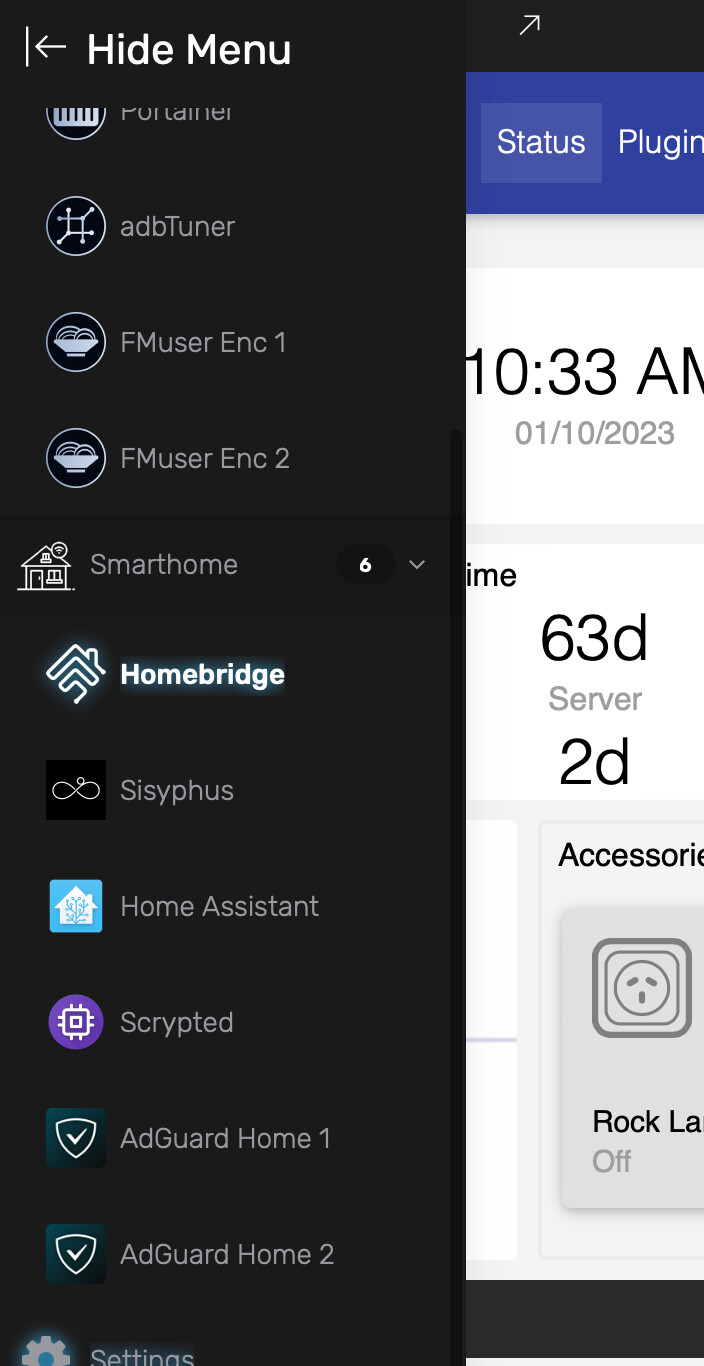

Organizr really is a great and thoughtful tool. I added bookmarks for other smarthome server stuff that I monitor and manage, into a category of its own.
All of these used to be in a bookmark group that would open many browser tabs. This "unified dashboard" approach is much more appealing.

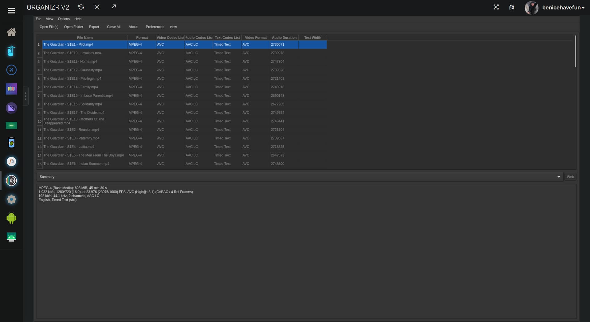

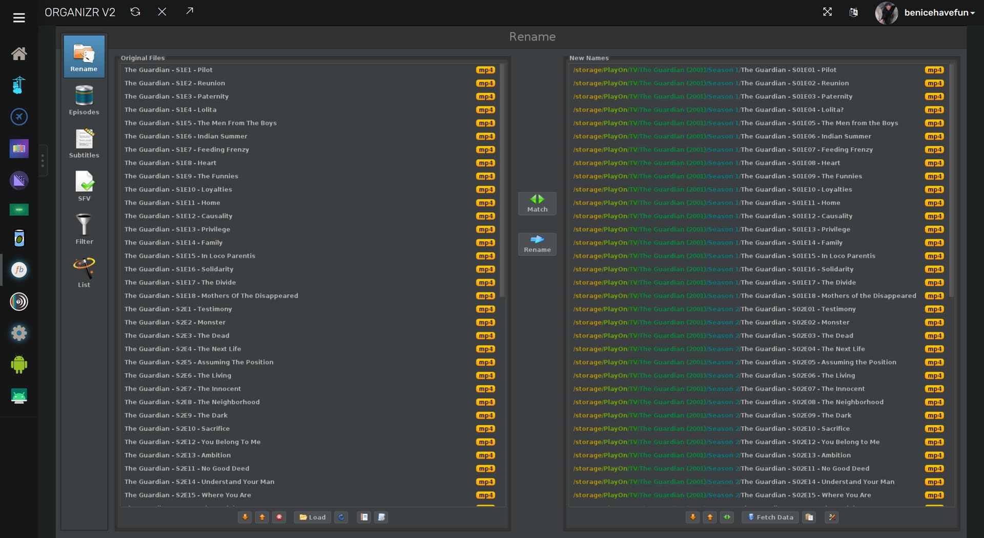

The first is FileBot, which is great for bulk file renaming:
Here's my recommended docker-compose:
version: '3.9'
services:
  filebot:
    image: jlesage/filebot:${TAG}
    container_name: filebot
    ports:
      - 5800:5800
    environment:
      - DARK_MODE=${DARK_MODE}
    volumes:
      - ${HOST_DIR}/filebot:/config:rw
      - ${DVR_SHARE}:/storage:rw
And, sample environment variables:
TAG=latest
DARK_MODE=1
HOST_DIR=/data
DVR_SHARE=/mnt/dvr
The second is MediaInfo, a well known and widely used program to list a wealth of details about a given video file:

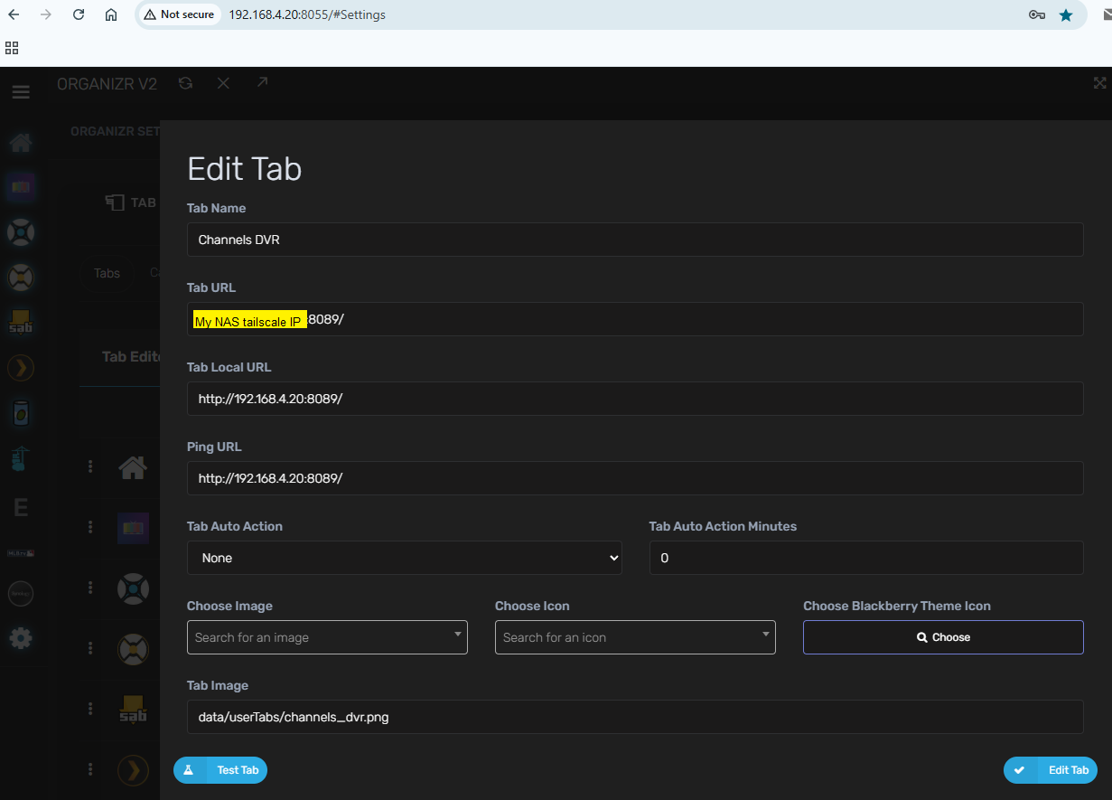

For example, my local NAS IP address is 192.168.4.20, and I'm running organizr on port 8055, so when at home I can just go to 192.168.4.20:8055, and I can access all of my webui's without issue (whether they are set as the "tab URL" or "tab local URL"). But when I am connected remote over tailscale, I can see organizer at "http://my_nas_tailscale_ip:8055", but now none of the tabs will work. And this is with setting the same IP for the "tab URL" as the one I connect to for organizr. And if I hit the little diagonal arrow to pop out that tab, it always redirects to the tab local URL, even when I am remote. Can anyone point me in the correct direction at all?

But whether you use MagicDNS or not, you should be able to do what you're after. The first question is, do you have all your WebUIs setup to load in an iFrame?
The next is, can you give me some example URLs you're using in your Organizr tabs (maybe a screenshot or two)?

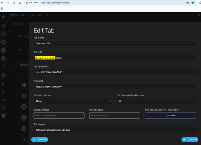

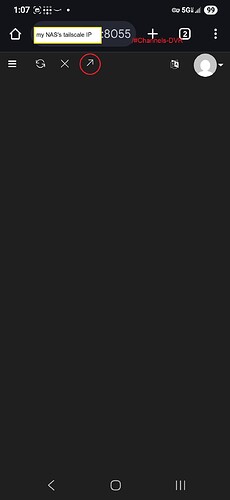

To answer bnhf's question, yes I have everything set up in iFrames. But I am not using magicDNS. Here is a screenshot of my setup for the Channels DVR tab. I have the other tabs set up similarly.

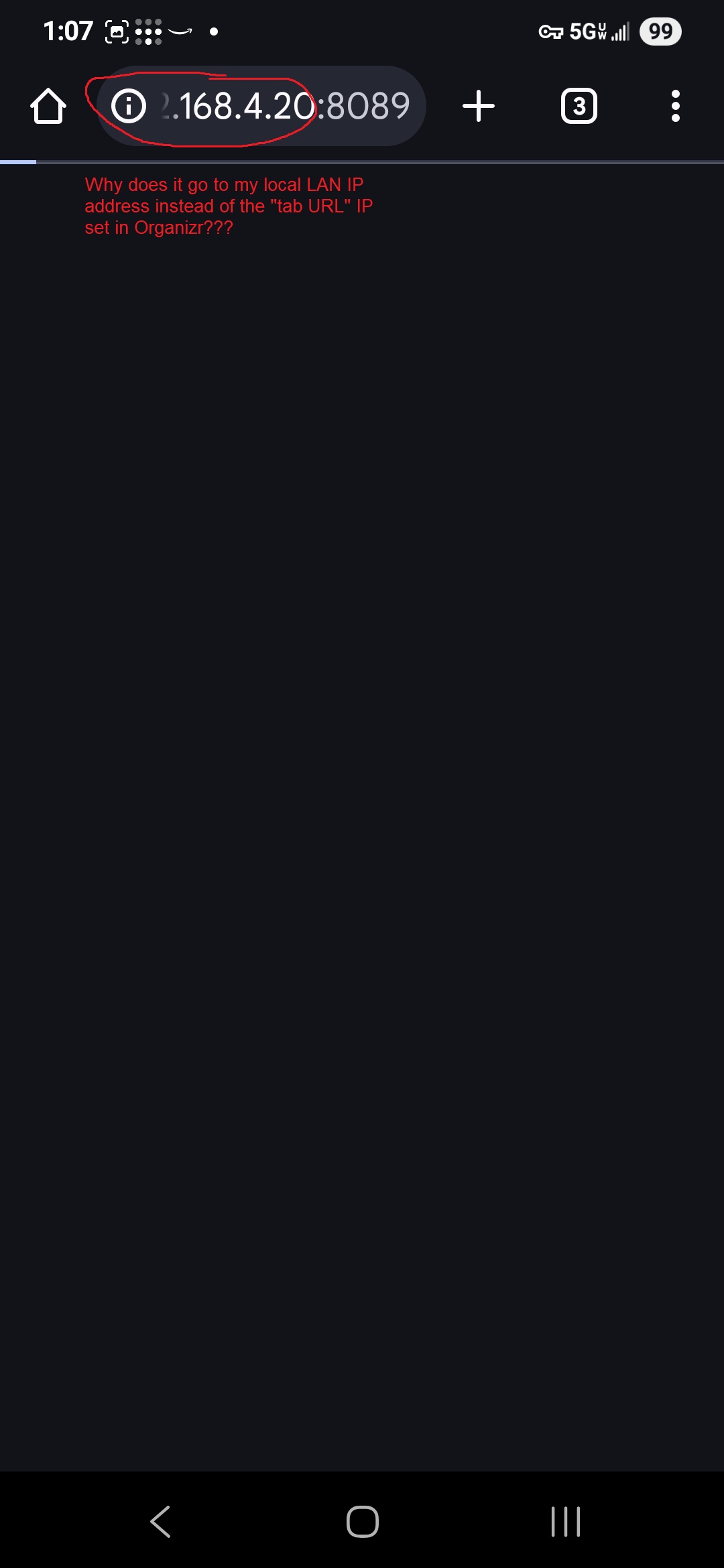

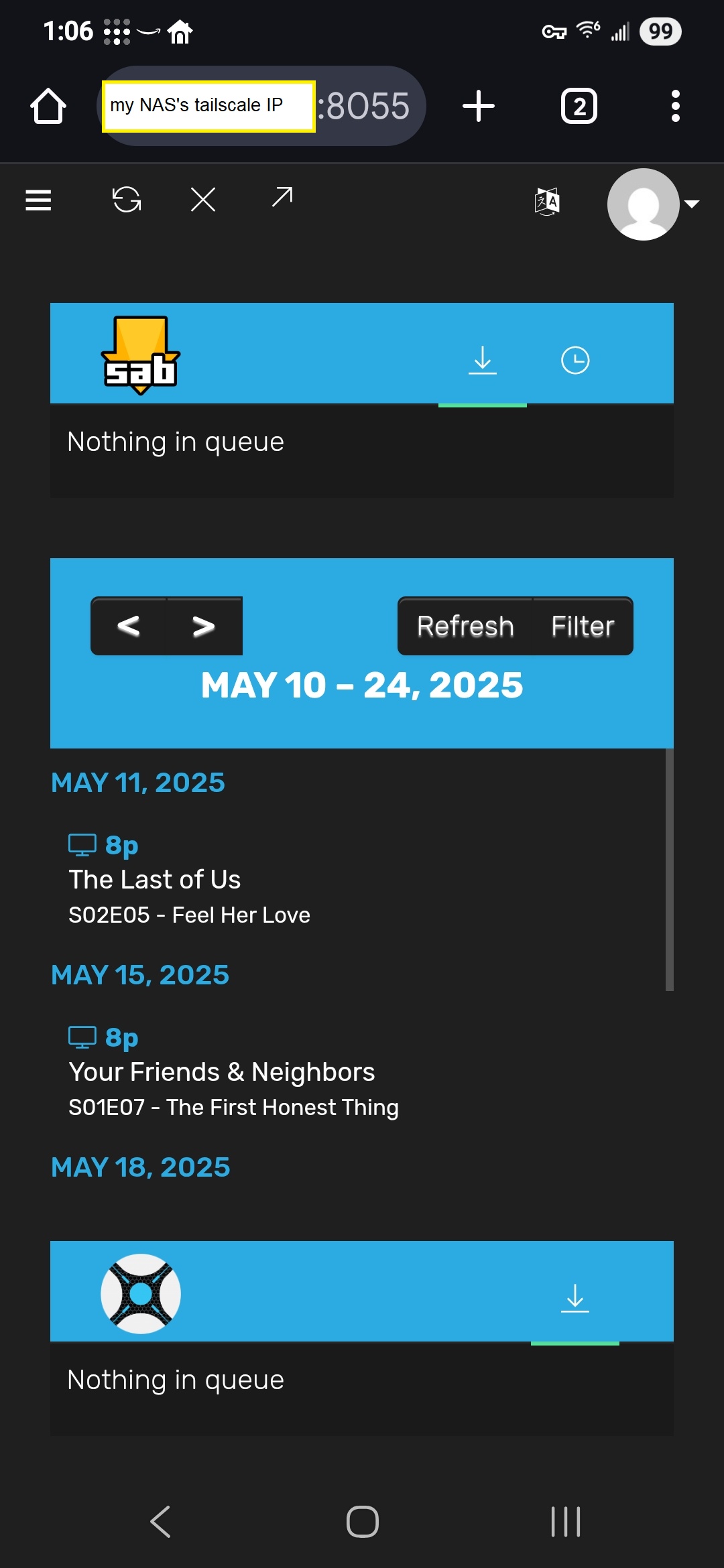

So, when I connect to the tailscale network remotely on my phone, I can access the homepage of organizr just fine by using my tailscale IP for my nas on port 8055. Like so:
But when I hit any of the tabs, I just get a black screen. And when I hit the little "popout" button, it tries to connect to my local IP instead of the tailscale one. I should also note that I can still remotely connect to Channels DVR outside of Organizr at this same point by just going to "my_NAS_tailscale_IP:8089". I just can't seem to get that redirection to work properly inside of Organizr.
I'd try removing the Tab Local URL and Ping URL values -- leave both blank. Organizr probably thinks you're local even when you're not. As long as you're using iFrames, and your NAS is using Tailscale, those 100.x.x.x IPs should work even when you're accessing Organizr from non-Tailscale nodes on your LAN.
Organizr have that bizarre bug in there for some reason. I too had to remove local url from there. I use tailscale to access that anyways so it's not too bad...
Thanks for the help. It now seems to work correctly for connecting remotely. It still wouldn't work on my local network on devices without tailscale, but after installing tailscale on the pc I use most frequently it now works there too. So I guess I'll call that good enough, and once again I really appreciate the help.
