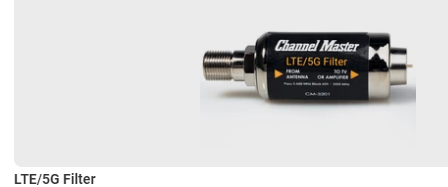

So, I got the new Channel Master LTE/5G filter and High Pass Filter.
The LTE/5G filter does have on its label what the manufacture told me via email is wrong, for the Frequency rand it passes/blocks, but without special test equipment, I can't verify what is correct.
Installed both filters.
Did effect things.
The wand massager now only glitches out 2 channel and their subs, instead of all, 11.1 and sub channels (201.000Mhz), 41.1, .2, ION, GRIT (485.00Mhz).
Which is a improvement.
(the 41 channels are the ones hard to get, lower signal, cause tower is very far away)
Did not affect the fan speed switch, but, that is not a normal use case, to keep switching it in rapid suggestion for several seconds.
So....glad to see improvement.
Pretty sure that is the best I can do at this point.

So basically, you setup a 'band-pass filter' using both a low-pass (LTE Filter) and high-pass (highpass) filter in combination. In combination they both act as a band-pass filter and a signal attenuator where you're getting less signal through to your HDHR, but eliminating interference from frequencies lower and higher than your band-pass frequencies of your wanted OTA channels..
