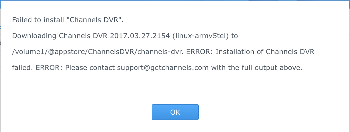

I've got a Synology 411J (yes I know it's ancient!) and I can't seem to get the Channels package to install. Here's the error message that pops up:
I've tried restarting the NAS and it's running the latest version of DSM (DSM 6.1-15047 Update 2).
Anyone got any advice?

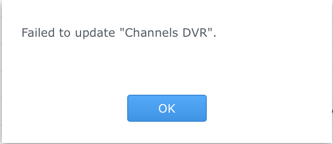

Unfortunately it still doesn't install. It looks like it's upgrading but then I get either the same screenshot as before or this one:
Maybe my old workhorse is not destined to be a DVR. :expressionless:
