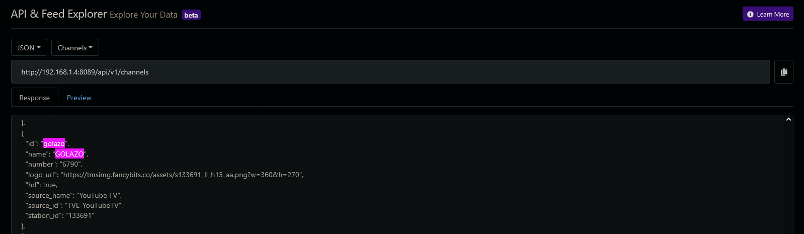

Not sure if this is the right place to post this. But running into an issue with the guide data for Golazo channel via TVE. Appears it may be a problem with the schedule provider itself as I am able to add the pluto M3U for Golazo and manually choose it for guide data and it's still showing incorrect. For example, 3pm today 9/19 is showing Scoreline, but on CBS Sports website it's showing the Middlesborough v West Bromwich Albion match.
Guide Provider issue.

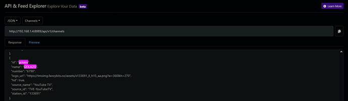

Only one gracenote station ID (133691) for the network and it's the same one being used for TVE, Pluto, Plex, etc.
Curious how you were able to check that? And who do I report it to?
Use the API & Feed Explorer (Support > API & Feeds) in the DVR web UI to find out what "station_id" a channel is using

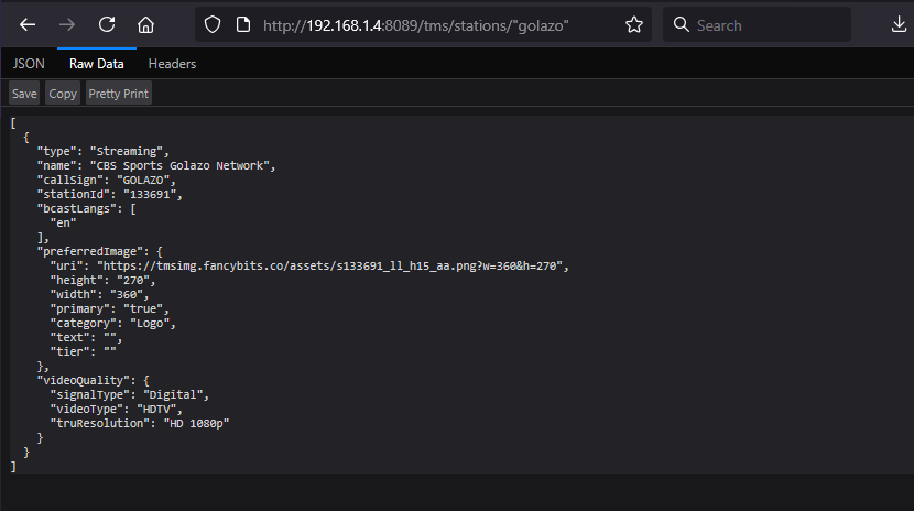

Then there are various ways to search for available gracenote station id's for a channel name or callsign. This one is using a web browser
Gracenote. But unfortunately you cannot contact them unless you have an API account with them.
And I doubt you could report it to CBS Sports, since their website shows the correct schedule.
