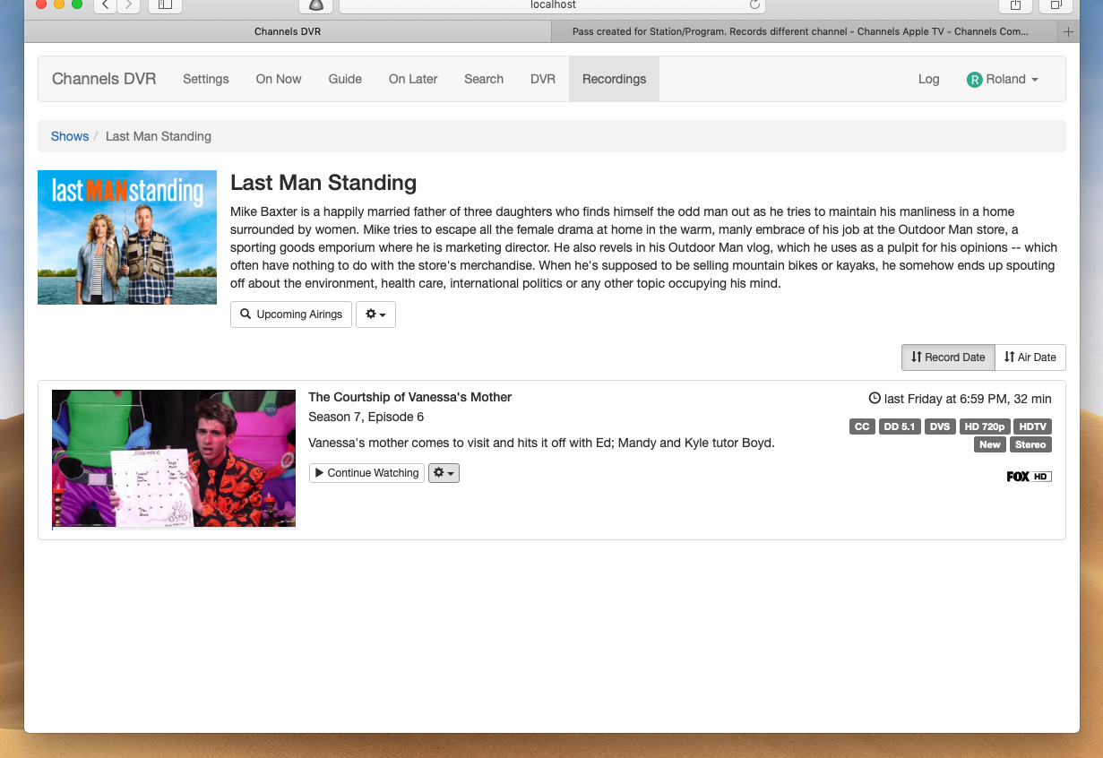

attached screen shot of what I intended to record and what it did record
