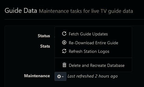

Try deleting and recreating the guide database.
DVR web UI Settings > Live TV & DVR > Guide Data > Maintenance :gear:
Screenshot 2024-11-25 at 12-00-02 Channels Settings
I've learned to do that whenever I make any changes to my sources, or channels within them.
Adding a source doesn’t do anything to reevaluate passes and job scheduling.
But that would have happened at the next scheduled time of tomorrow morning. A new pass would have picked up on it too. And of course, forcing it like @chDVRuser mentioned.
