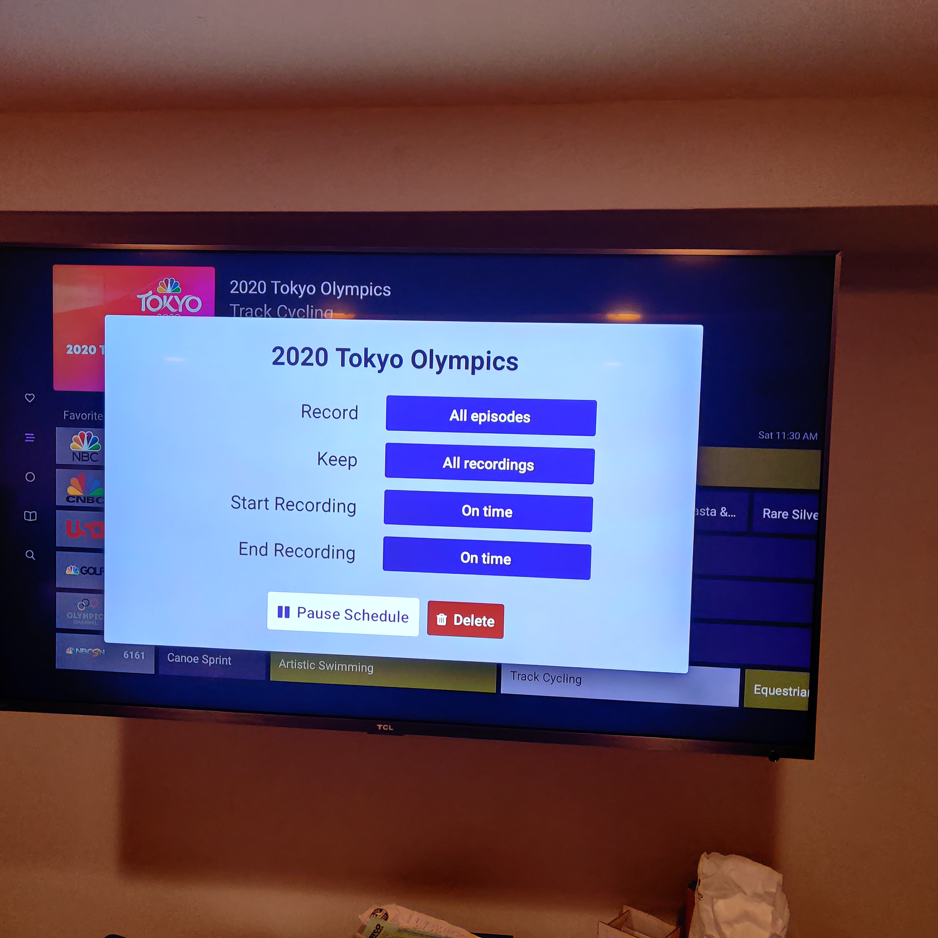

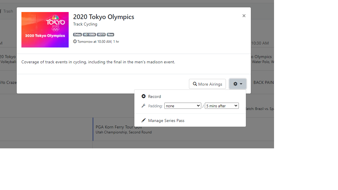

AS you can see in those screenshots I've posted, Channels seems to have correctly identified this airing as a new event, associated with the series pass but it is not currently scheduled to record.

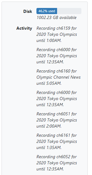

EDIT: I've also noticed something else a bit odd, not sure if its related. The DVR appears to be recording something twice.

Perhaps the first recording was scheduled because of a rule, and the second was set as a manual recording?
