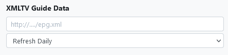

Something else you could do instead since it seems like you are doing something odd for TVE stations, if you exclude the XMLTV Guide Data (you might have to re-create the source and not fill it in) ...

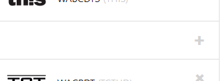

... then you can manually select what each channel is with the + button ...

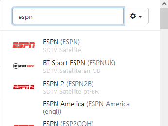

... change the gear icon to Search All Lineups ...
... and find and select the station.
This will give you the full Gracenote guide for the entire 2 week timespan of that station.
