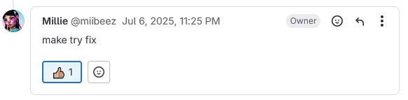

Someone opened up a ticket with @miibeez, too:
I linked to your comment here so they would have the info there, as well. As others said, we'll now have to wait for them to apply the fix.
Looks like there's an update. So give that a whirl and see what happens
Pulled latest, started and can stream via Channels again now. Thanks!
Yes, all working now. Thx
Yep, can confirm as well. From the dev:
