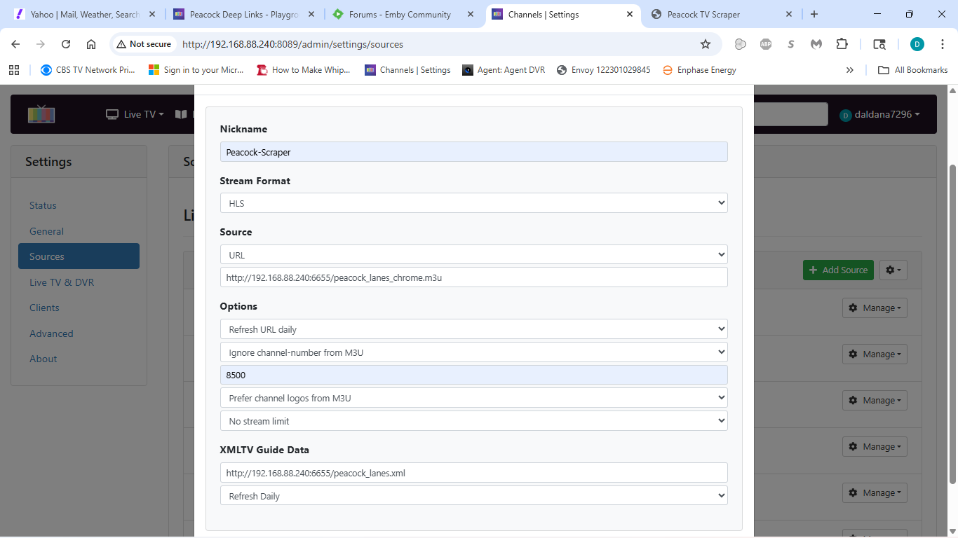

Show a screenshot of the custom channel you’re trying to add (from admin page).
Here you go. I've also tried http://192.168.88.240/chrome/m3u and a couple of other variations.
I'm seeing the stream format set to HLS. usually, it would be mpeg-ts.
If you are trying to launch an app, it would be a streamlink i'm thinking.
thanks

Ok, setup custom channel as a streamlink (see screen print below) and Channels takes it. I get an epg, but when I try to play anything, chrome does not open up and no video. I've tried both the node version of cc4c and the docker container version.
As an aside, I also tried the direct links version in Emby with the same result.
