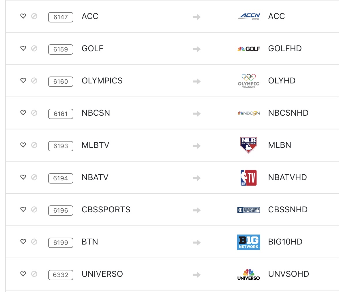

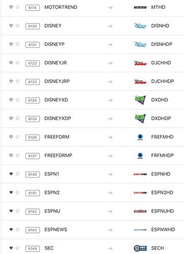

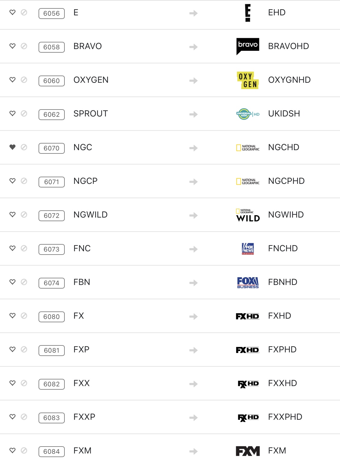

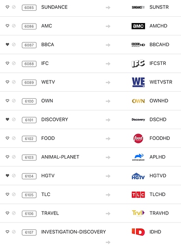

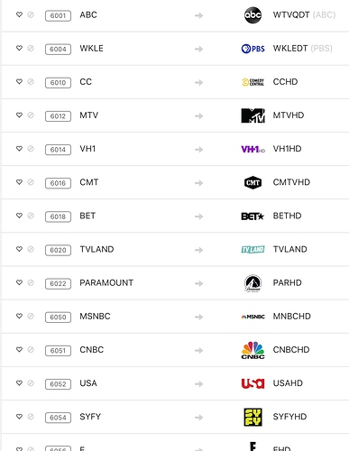

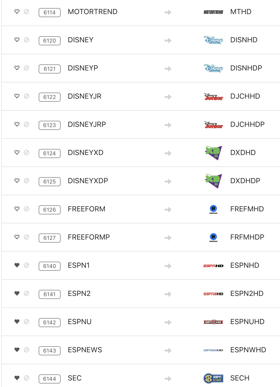

Also important to note you will not be able to access all channels in your YTTV with Channels via TVE. I would highly recommend reading the documentation provided for TVE to get a full understanding of how it works. I’m also including screenshots of the channels I currently get via YTTV.

Macnbaish - thank you for sharing your screenshots. I see that you're getting ABC (channel 6001) but not the other network TV channels (NBC, CBS, FOX)? Is it because they're not available in your YouTube TV lineup, or is it because Channels can't pick them up?
Local channels via TVE are still considered experimental and are kind of hit or miss, I believe. What you will get might vary widely from market to market. As such, I wouldn’t count on TVE for local channels. Personally I use an antenna for that but many others use Locast, if that’s an option in your city.
Edit: To clarify, I do have access to all my local channels via YTTV, but only get ABC and PBS via TVE in channels.
