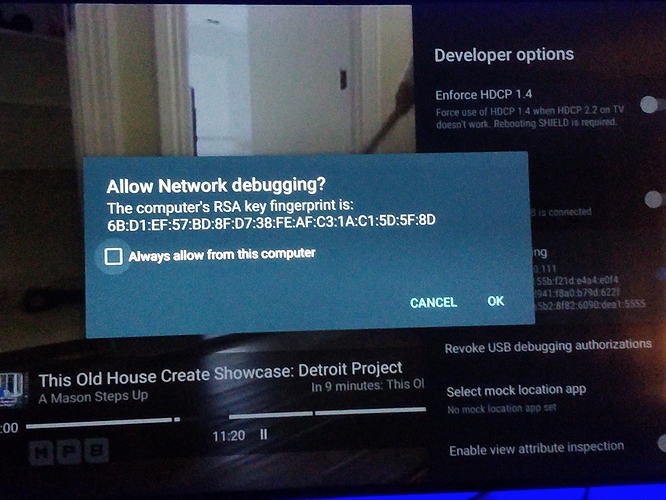

Thanks for your response. I'm close but still not there. I was able to confirm on the shield a connection. However when I click on "grant write_secure" on button mapper I still don't get a connection. Does the shield have to connected to pc or does it connect on wifi?
I had a lot of trouble to. So I did the adb connect, ignored that connect button in the program, hit the grant button
Also, did you go to your device after you did the connect and authorize the connection?
yes I did hit the grant button. what do you mean hit the grant button?
what I mean is I did authorize on the shield
The one that says "grant write_secure"
It's successful when that option changes to 'revoke write_secure"
I appreciate all your help but I'm just not able to configure. I'm connected to the shield and have authorized but when I go to configure in button mapper on shield and go to advanced v2 I get noting but the advanced setup screen. I guess I'll live with the PiP the way it is. again thanks for trying
So close I see...
The part in windows where you click the 'grant write_secure_settings' is not applying, and this is a connection issue.
You should see what the command "adb devices" reports
You should see your Shield
Then you can click the button for 'grant write_secure_settings"
ran "ads devices". Did not see my shield in "list of devices attached". Perplexed as to why.
Hey, Success!! I was not running cmd prompt as administrator. ugh. thanks so much for your help. Cheers.
I honestly don't think it matters, Im not using admin either and it worked. It's just testy with the connection. The connect button in the app is useless.
