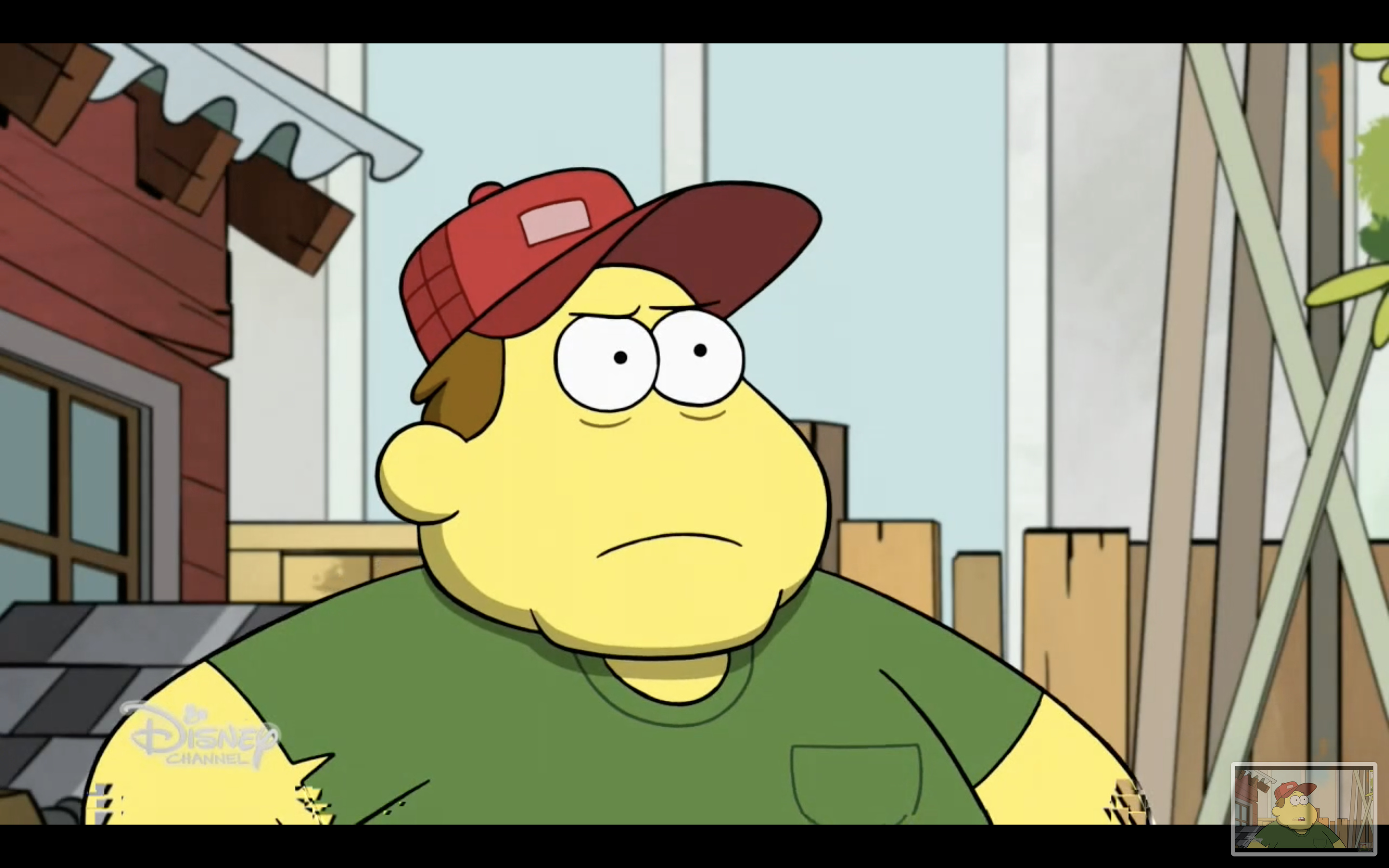

I have two HDHomeRun Prime's and I'm getting pixelation at the bottom portion of the picture. It's only happening on cable channels (Disney, FX, USA, etc) and not my local channels (ABC, CBS, NBC, etc). I had my cable company come out to check my levels and all levels are healthy. I've worked with Silicondust support to troubleshoot if it's a hardware or firmware issue and they advised it's a software issue. The discussion I had with them is here:
https://forum.silicondust.com/forum/viewtopic.php?f=113&t=73863&sid=9b7835abc585aad107eace23860bfed6
I've done the following testing and here are my findings.
On Apple TV 4K with both the Channels app and the Plex app, the pixelation occurs on the Disney channel.
On Roku TV with both the HDHomeRun app and the Plex app, the pixelation does NOT occur on the Disney channel.
On MacBook Pro in Google Chrome watching live tv from Plex, the pixelation occurs on the Disney channel.
On MacBook Pro in Google Chrome watching live tv from Channels DVR website, the pixelation does NOT occur on the Disney channel.
On iPhone Xs Max with both the Channels app and the Plex app, the pixelation occurs on the Disney channel.
Is this issue caused by a software change in recent months? This didn't happen until a few months ago.
