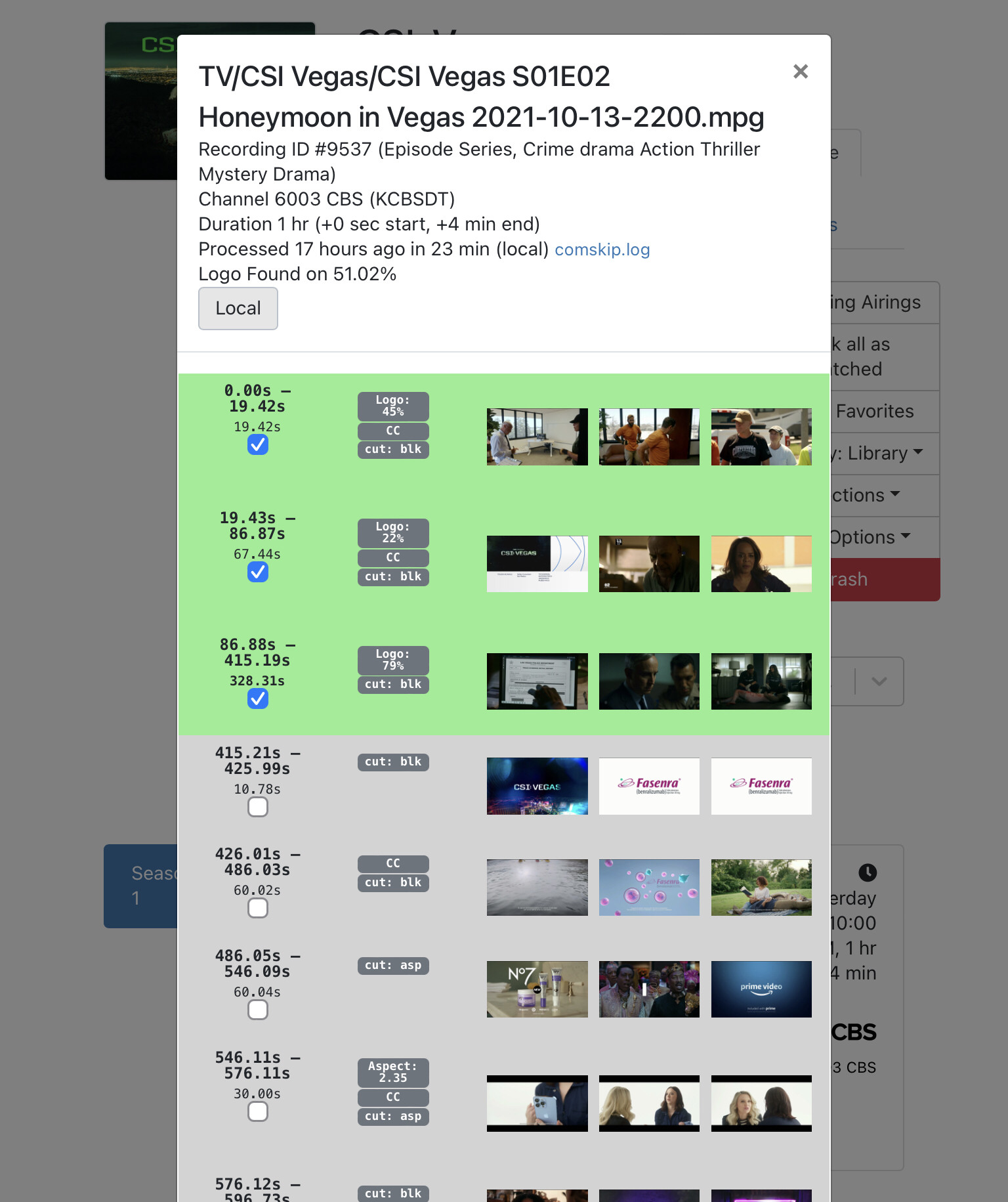

The Verify Commercials action opens an editor that allows you to adjust where the commercial markers are. You then can mark it as verified and Channels trusts them a bit more.

I’ve actually never seen or known there was a verify feature. I looked for it on the web interface in my library on some programs that had commercial detection, but couldnt find any menu item to verify in the web UI. I searched in the forum and there was an example of a program with a green verified symbol in the library, but couldn’t for the life of me find any editor. Of course I’m only on second cup of coffee now.
However, I can confirm I got to the verify editor on my iPad. I couldn’t figure out how to fine tune the commercial points vs just accept what is displayed by clicking on the previews. Is there a way to “jump” into the previews for more granularity - which would be really really cool.
Way back in the day I used to use eyetv on my Mac and you could zoom into and mark really exact endpoints and then even export a new “compacted” file.

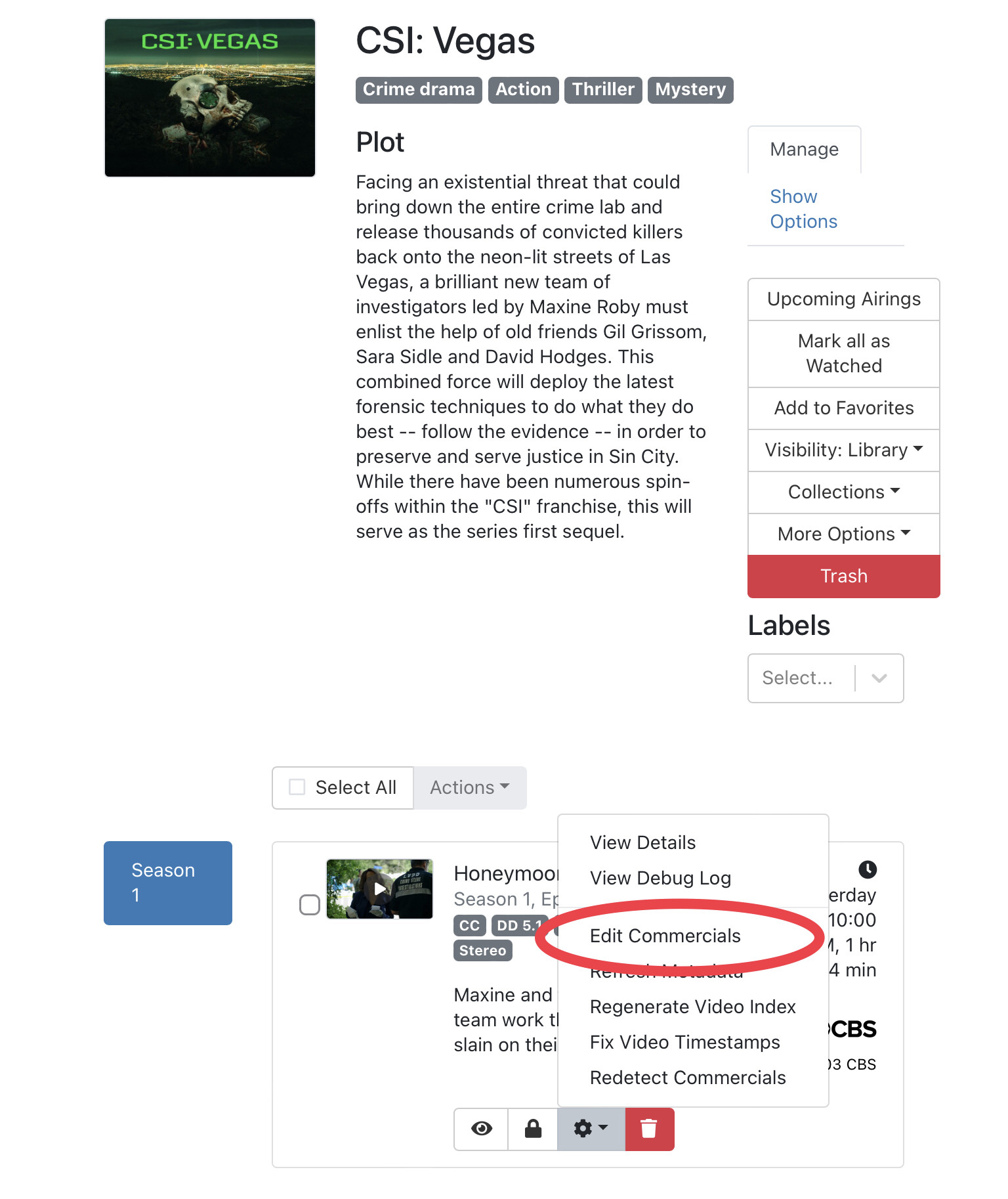

From the show's page in the Library, look for the "Edit Commercials" option:
