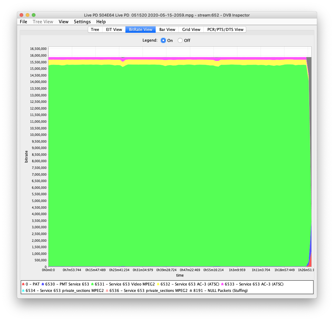

It looks like something weird happened at the cable company encoder, towards the end of the episode. All audio/video packets stopped coming though, even though other metadata packets were still present.
This has surfaced some bugs in transcoder and player which we are looking into.
Understand. Have seen issues where PIDS change midstream and PMT not updated or Audio goes flat silent or its packets go corrupt or missing. I write it off as Cable Company issues..

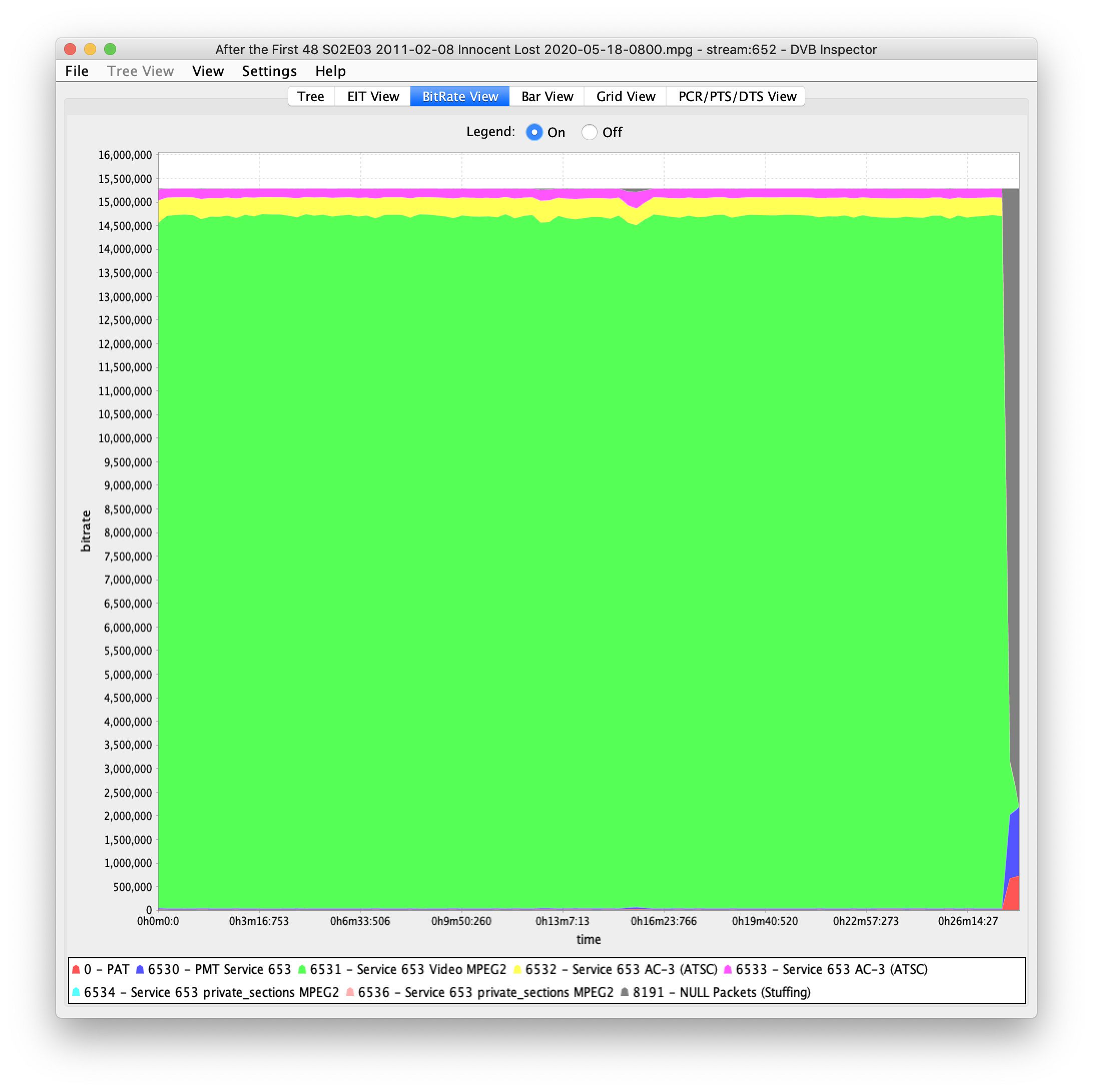

I deleted the recording of LivePD, so I can't do it for that one. I refreshed the meta data for the After the first 48 file and it shows that it is only 28 Mins, when the program was an hour and the Apple TV will play the video back and the web player will also now play the video back where as before it did not. I hope this helps a little is squashing this bug. Also, logs sent from the Apple TV.

Both recordings show the same symptoms with audio/video packets dropping off near the end:

and for the recording that was showing issues, the signal quality dipped as low as 84%:
2020/05/18 09:00:30.021208 [SNR] Statistics for "TV\After the First 48\After the First 48 S02E03 2011-02-08 Innocent Lost 2020-05-18-0800.mpg": ss=88%-89% snq=88%,84%-89% seq=100% bps=15191243,1684480-19039136 pps=1056,23-1808
