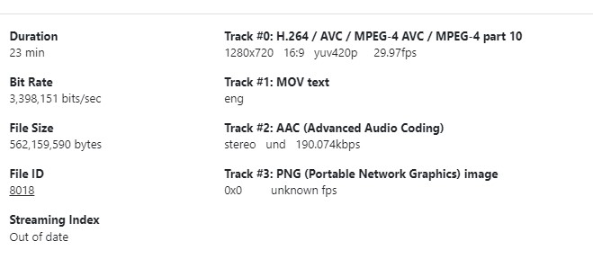

What does View Details for that recording show
The details vary between recordings (for tracks other than 0), but the behavior of left/center instead of left/right is consistent on all recordings done by PlayOn Home.
Example 1: Recorded with PlayOn Home from Peacock:
audioissue-ys

Not sure I understand. Bear with me. The two examples I showed behave the same way when played in my home theatre setup - the receiver says Dolby Digital and sound comes out the left and center speakers; absolutely nothing on the right.

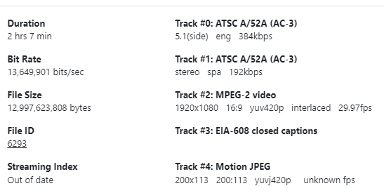

If you mean look at the differences with files that play correctly on Channels Apple TV client, we have
Example 4: Imported to Channels from a Windows Media Center file
Example 5: DVR recording from Channels
