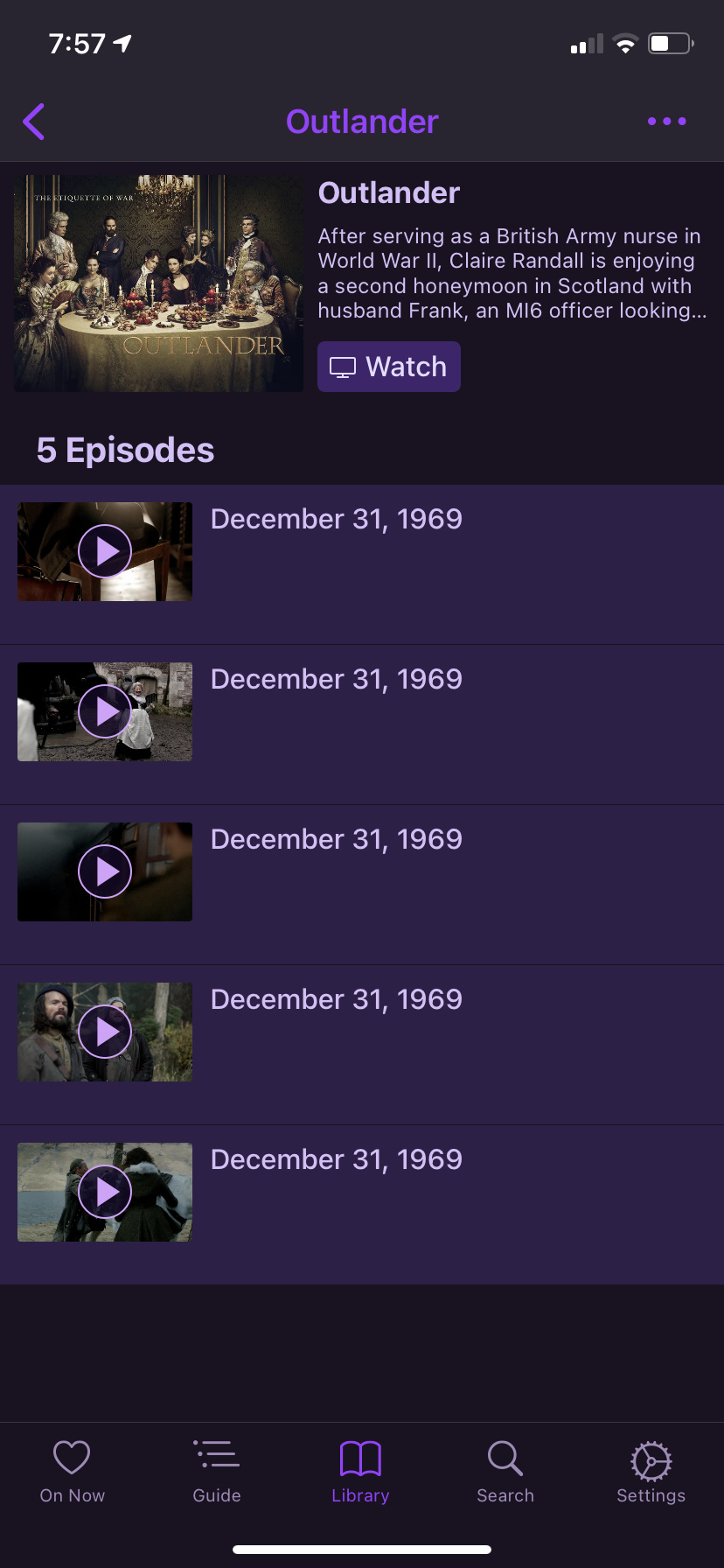

I love the PlayOn Cloud recordings that push to the server! I’ve been using PlayOn for years and this makes it much easier - Thank you!
I was recording Outlander from Starz but the metadata for the episodes was not populating. On the server I found a place to refresh metadata, and to fix incorrect match, but that doesn’t seem to work.
Any suggestions would be appreciated!

I can edit the text box, but there's no button to check for a match, and when I make adjustments it just says no match is found. I did update to the latest pre-release and submitted the diagnostics.
I noticed that in the PlayOn file folder where the files are kept that it is not using the typical numbering - S01E01 - (Name of episode). It says Outlander - Ep 101 - (Name of Episode). Season 1 is numbered 101 for episode 1, 102 for episode 2... Season 2 is numbered 201 for episode 1, 202 for episode 2.

I was able to match each episode’s metadata in the latest pre-release manually. It doesn’t appear to do it automatically, but at least it’s matched. Thanks!
Glad you were able to match manually. PlayOn support said they're aware of this issue with Starz and will fix it to use the same naming scheme as other providers.
I've also fixed this on our side in the latest prerelease, so season/episode information is always tagged correctly into the downloaded filename.
