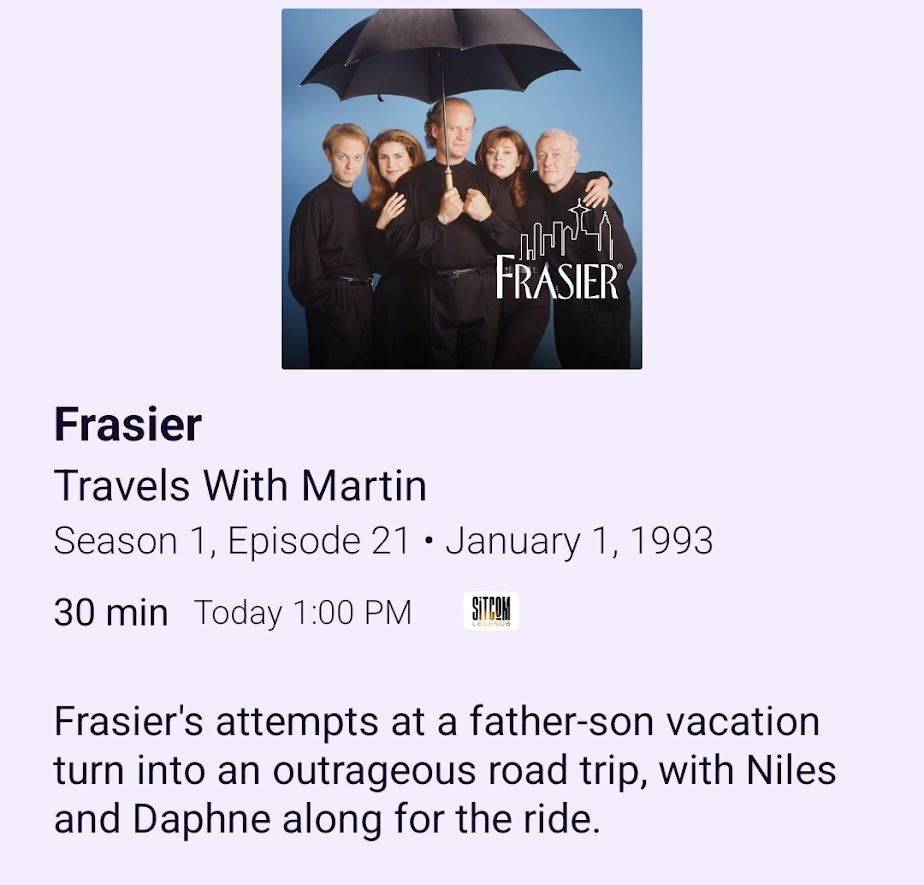

The main difference I can see is the formatting for the episode-num system="original-air-date" field. When I looked at the Guide on a client, it didn't seem to show original air date. However, if you check a recording, it certainly is available and takes it from the XML:

Here, that field isn't even being used at all! It seems to be happily taking <date> and using it for "original air date". So here's what I'm thinking:
  • Channels has a priority of determining what to use for "original air date". If it doesn't find episode-num system="original-air-date", it moves on to <date>.
  • If Channels finds episode-num system="original-air-date", it is expecting a specific format. Namely YYYY-MM-DDTHH:MM:SS.sssZ. If the format is incorrect, nothing is displayed.
  • More so, if the format is incorrect, Channels does not fall back to <date>.

It certainly looks like a format issue....
jgomez
19920206000000 +0000
nocords
1992-02-06T00:00:00.000Z
Maddox docker also is ..
2021-05-06T00:00:00.000Z
Should be corrected in version 1.08
All good!
