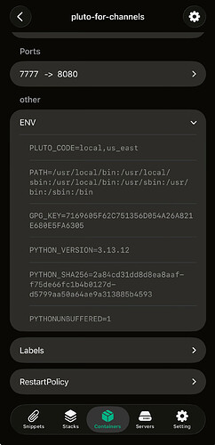

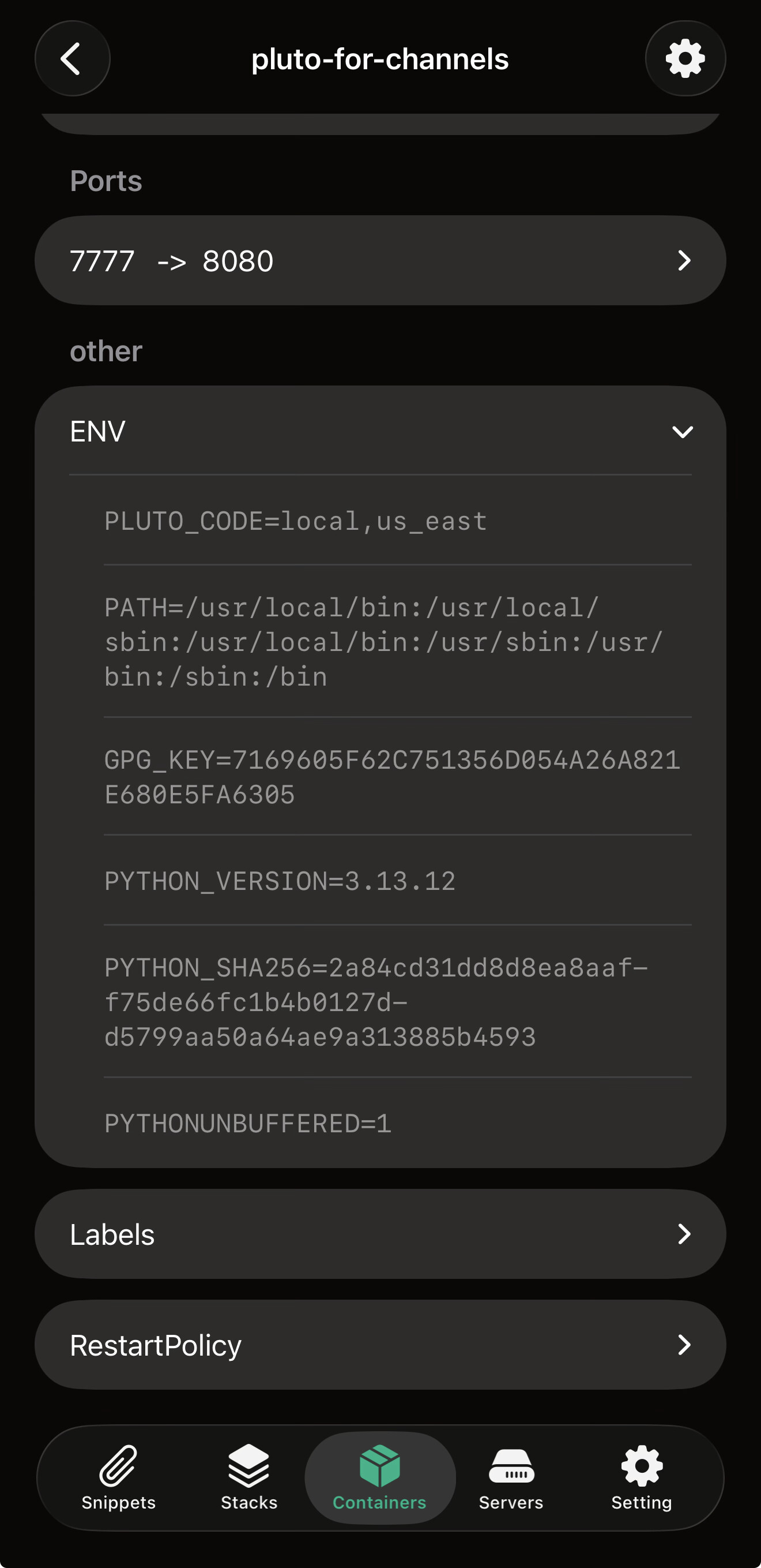

@KineticMan really appreciate your work on this.
One question, should we be able to specify a different port? I assume changing
ports:
  - 7777:7777
to something like
ports:
  - 7790:7777
should work?
yep just leave the second one at 7777 (it's just the internal container port) but feel free to change the first to whatever you prefer.
cool, that's what i thought. wasn't working. i'll get it sorted just wanted to make sure that it was capable!

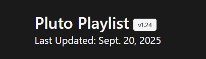

Anyway you can update your date on this. Still shows September.

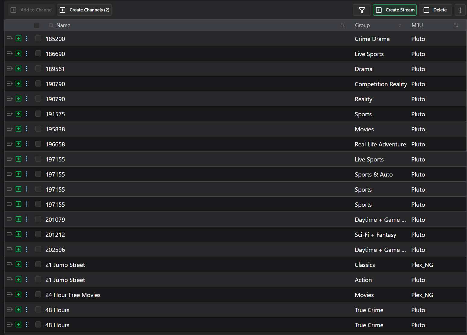

Not sure if this is specific to the m3u aggregator I use (Dispatcharr), but when I import the M3U from this docker, I get the following:
It's not all the channels, but about 300+ of them. I looked up and the channels that are doing this have the following:
#EXTINF:-1 channel-id="ironside-gb" tvg-id="6900997e043e3df1897d017f" tvg-chno="7208" group-title="Crime Drama" tvg-logo="https://images.pluto.tv/channels/6900997e043e3df1897d017f/colorLogoPNG_1761664014410.png" tvg-name="185200" tvc-guide-title="Ironside" tvc-guide-description="A paralyzed police veteran becomes a special consultant to the force.",Ironside
http://192.168.0.5:7777/pluto/all/watch/6900997e043e3df1897d017f
vs those that don't:
#EXTINF:-1 channel-id="48-hours-gb" tvg-id="6299e5afdd5833000727e795" tvg-chno="7361" group-title="True Crime" tvg-logo="https://images.pluto.tv/channels/6299e5afdd5833000727e795/colorLogoPNG.png" tvc-guide-title="48 Hours" tvc-guide-description="Pluto TV 48 Hours brings viewers behind the scenes of the most intriguing murders. Follow the investigators, meet the accused, and review the evidence in the original true crime docuseries, with stories of obsession, revenge, and crimes of passion.",48 Hours
http://192.168.0.5:7777/pluto/all/watch/6299e5afdd5833000727e795
Basically it looks like the absence of [tvg-name=] causes Dispatcharr to fall back to [tvc-guide-title=] which in my case is the desired state since [tvg-name=] is a number and not the channel name. Is there a future that may include an m3u option that doesn't include [tvg-name=] or at least defaults to [tvg-name=] to the channel name and not the number?
Thanks.
That's most likely the case as SLM doesn't have this issue. You'll have to bring this up to the Dispatcharr devs
Thanks, posted a issue on his site. Although, I wouldn't think it's expected that tvg-name= should have numeric values, I would think it would be "ESPN", "WGAL", HGTV", etc. But I also know I am only a user and not a programmer and what may make sense to a layperson may not align with the coding perspective.
I will say all other imported sources I've used doesn't have this issue (PrismCast, SamsungTV, Plex, ADBTuner, Tubi), but as you said, it's not an issue with other solutions so let's see who may step forward with a solution.
