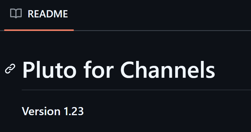

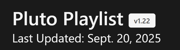

Looking to see which is the correct/current version...
Here is the one I'm tagging: image: kineticman/pluto-for-channels:main
Here is the local container's web page:
Here is the Readme:
Just wanted to make sure I have the latest...
You have the most current version either 1.22 or 1.23. It is a typo probably in the Readme.

Anyway you can update your date on this. Still shows September.
