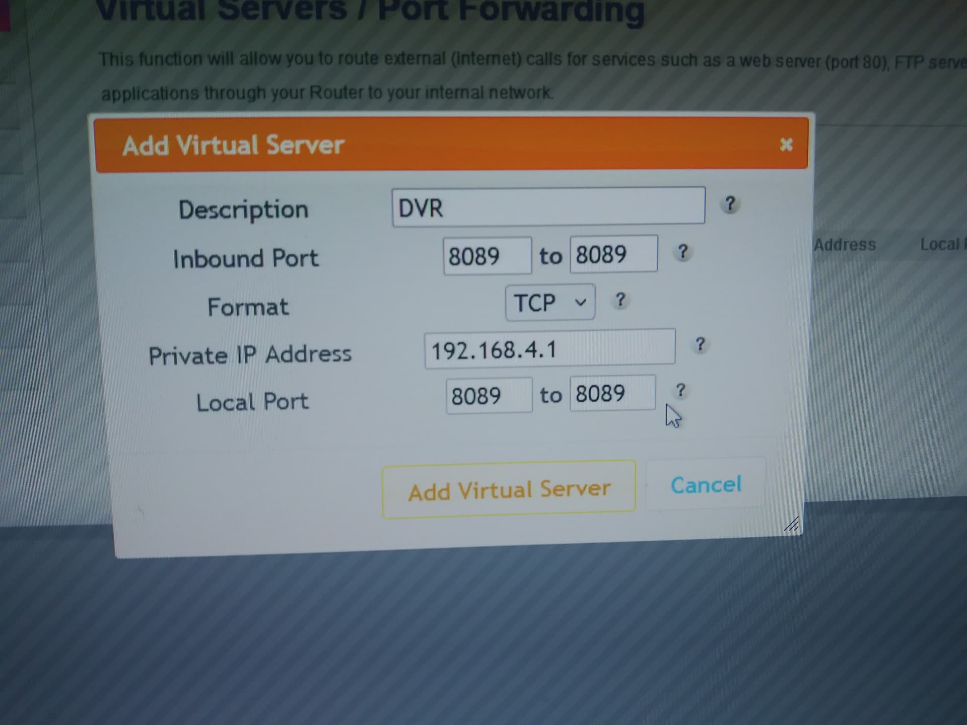

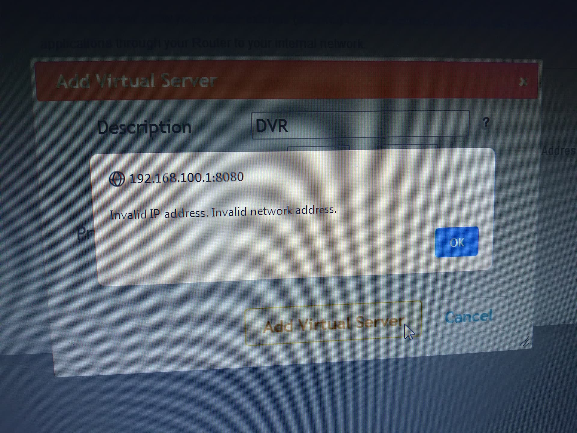

I have an arris modem from my provider and have eeros attached. I believe I have it set up correctly in the eero app but when I go to do it in the arris it will not save says the ip address is invalid.

It is in there and I have followed all the steps from arris help and still get the error when saving.
Screenshot of IP address screen?
Also you don’t need to put a range format if it’s just the one port. (You should be able to just put 8089 in that box in your screenshot).
The IP on the ARRIS side would be the IP of your main eero router, not the DVR. You have a double NAT so you need to setup a port forward chain, where the first router sends the port to your second router, and the second router sends it to your DVR
You could also disable the double nat which from a networking perspective is recommended. Also makes it simpler
You're using the eero IP scheme instead of the arris ip scheme. On the arris router there should be a list of clients, you need to find what IP is assigned to the main eero there
Or on the eero interface look for the WAN IP
