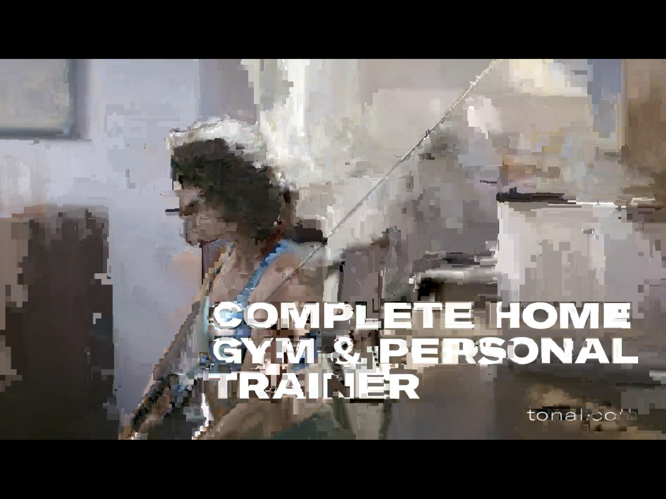

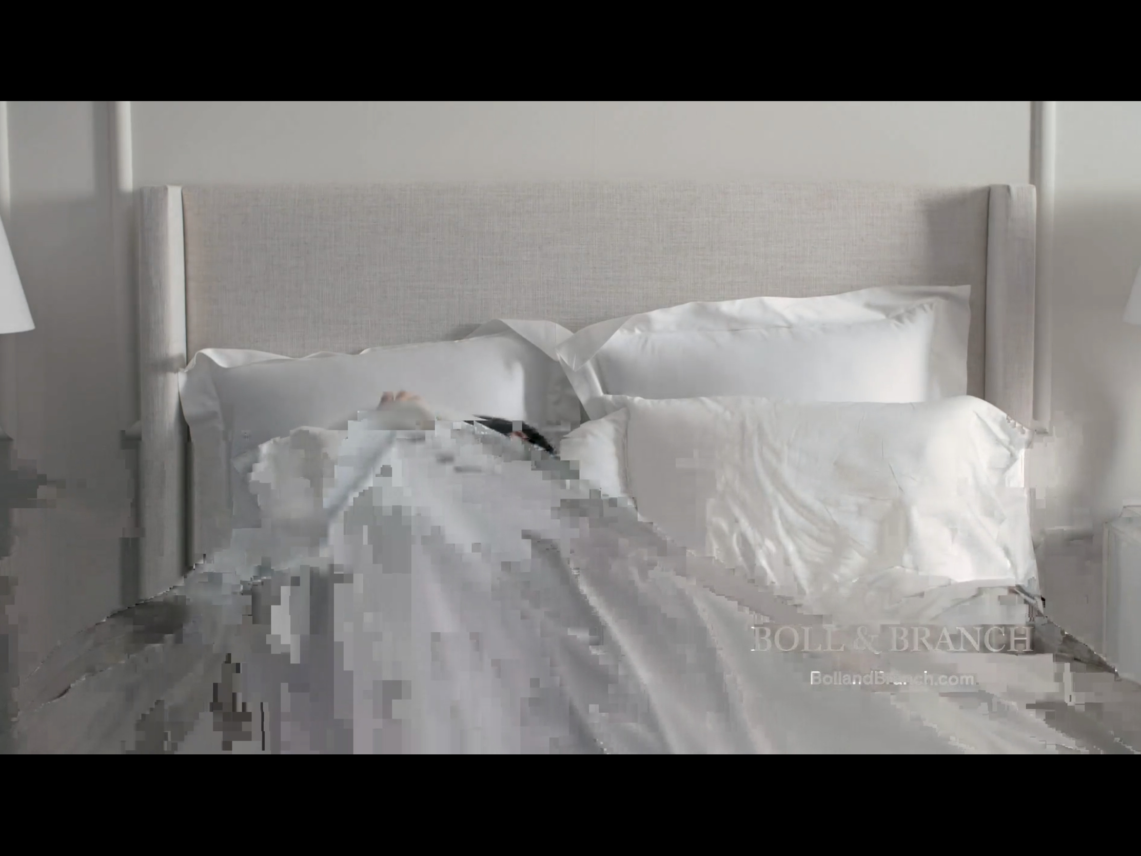

The problem I noticed in some cases channels have blurry and blocky pixelation and, in some cases, it is very hard to watch. Generally speaking, local OTA channels are fine but Premium Channels such as Oxygen, IFC, and TBS just to name a few are difficult to watch. Naturally I started to scour the Channels DVR community forum for a solution and noticed many people have the same issue but also noted there was no real solution.
I started to think that I am running Channels DVR on my QNAP TS-251+ NAS and perhaps it is not powerful enough but then concluded Plex ran on it without an issue and I remember Channels DVR was running on it a few years back without issues.
So, I am sort of stuck on finding a solution with the pixelation issue. Does anyone know what is causing this? Are there debugging steps I should be taking?
I did attach a few examples of the issue.

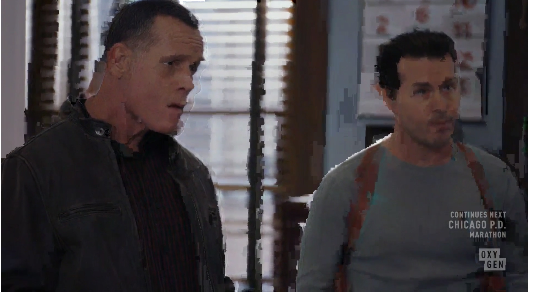

By TVE you mean the premium channels, the answer is yes. I still get pixelation. I did attach a picture of a show on the Oxygen Network.
