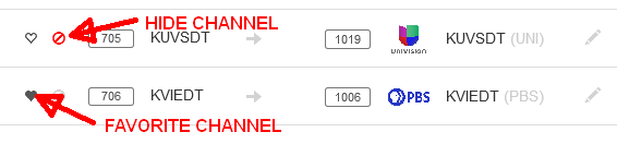

After it scans and finds the channels and loads the guide, mark your favorites and hide channels you don't want in the Channels DVR web UI.
