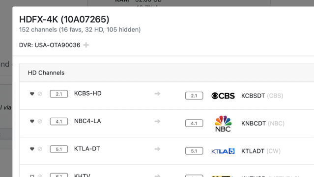

I get NBC via OTA (an HDHR Homerun Flex 4K) as well as TVE. I prefer the OTA source in nearly all cases, but very rarely, I think due to weather, the signal isn't great, and I look to the TVE signal (6000) for a backup. The HDHR is prioritized as a source on the DVR, as well as client. And the OTA channel (4.1) is the only one marked as a "favorite." Channel 6000 isn't marked as a favorite anywhere.

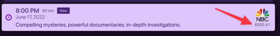

I set up a one-time recording of an upcoming airing of Nightline, via the AppleTV client of Channels.
But for some reason it's scheduling to record from the TVE channel.
I'm aware I can manually change this on the DVR, but is there a way for these types of recordings to automatically always default to the OTA source?
Is this the issue, then? If so, at least with my setup, it seems to be prioritizing a non-favorite over a favorite, from a secondary source, simply because its channel number is higher.
I ran into something like this with a m3u source saying a station was HD and the HDHR station that was favorite'd saying the station was SD. By the logic HD > SD > favorite, even if the SD is the favorite. Is there some weird way that 4.1 could be saying it is SD?

Ooops, sorry, I included the wrong screenshot, I was meaning to reference NBC only, for Dateline NBC (on channels 4.1 and 6000.). I've since removed the screenshot referencing Nightline.
I did a SEARCH in the tvOS client for "Dateline" (there are 8 different shows with this in their title) and I chose Dateline NBC and set up the one-time recording from there.

My guess is that client has the TVE source as higher priority than the HDHR source.
