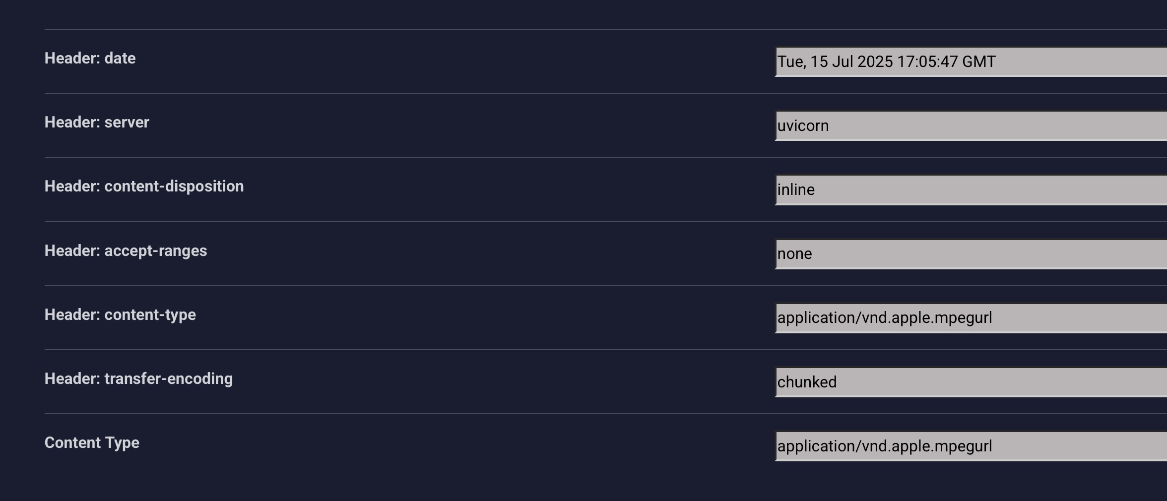

There were a few 404s on the playlist in SLM, but that was expected. the rest of the channels "responded 'HLS'"
Here's a screenshot of the channel i've been testing with
