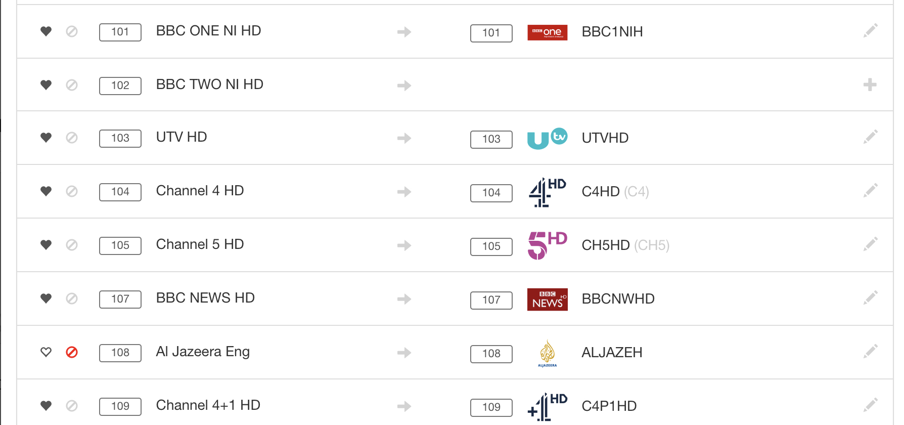

I have problem with logical channel numbering as I cannot specify the LCN for DVB and I can receive two DVB providers - UK via NI and ROI via RTE. This is not such an issue as I simply ignore the SD channels. However I am unable to enable BBC2NIHD. The Quattro can see it as confirmed in the web interface for HDHomeRun. Channels can see the channel but gives me no option to map this to a channel. When I select the option to edit the channel 102 is not in the list of channels I can map to.
I have tried everything including rescanning. HDHomeRun finds 102 and I have it marked as a favourite. However I cannot map 102 in guide and channel lineup to a channel on HDHomeRun as the list of available channels to map to does not include 102.
I have attached some grabs from the Channels DVR and the HDHomeRun.
