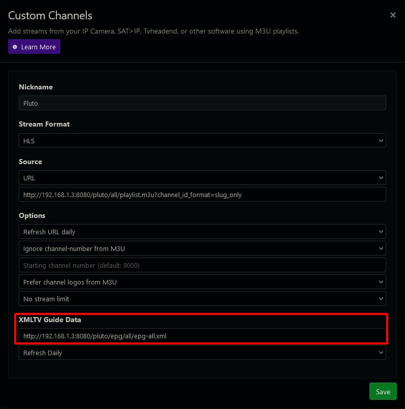

I apologize for my vagueness. I get the 3 M3U files from IFLEX and edit them with XEEV. I use the edited M3U files from XEEV and, as I remember, the EPG info from gracenote. Then I manually assigned the channels. Should I use the EPG channels from XEEV? If so, where is this set?
oh, I see the spot for XMLTV setting
You add an XMLTV source to a Channels DVR Custom M3U channel here
Clicking that Learn More button takes you to their documentation
