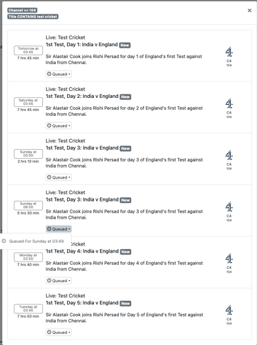

I've got a pass set up to record Test Cricket to be shown on Channel 4 here in the UK.

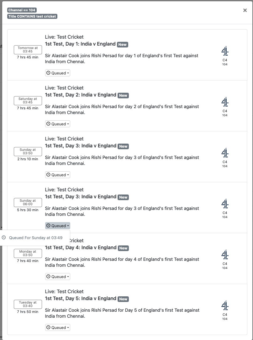

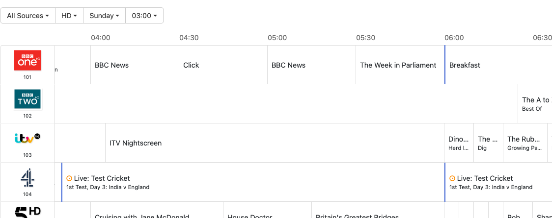

Generally it seems like it is set up to work correctly, except for on Sunday the broadcast seems to be split into two:
That is resulting in the pass not picking up both parts to record because Channels thinks that it is the same show:
How can I get Channels to record both parts? I've tried setting up two passes, one for long broadcasts and one for short. But that doesn't work because still Channels thinks that it only needs to record one, not both.

It will record the one airing first, so adding a lot of trail padding will work. Unfortunately, this is one of the edge cases that channels doesn’t handle well. It really doesn’t like recording the same show twice. The only other way I can think to do this is with a manual recording but that is much more complicated as it’s command line.
In the latest DVR pre-relrease, I've made it so you can force record the second half. The guide still acts wonky and won't mark both programs as scheduled, but you can check the actual DVR Schedule which is the master list of what to record and both will be scheduled there.
