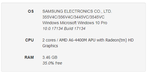

My provider is Spectrum. I’m Using Netgear R6400 AC-1700 Router. Here is an Image from Channels DVR Setting screen on Laptop. My Download is 200 Mbps and upload is 12 Mbps. ftp to my NAS drive and can playback the mpeg directly with no issues in playback. So the upload speed at 12 is sufficient.

For headless machines/servers, 4GB is quite adequate; for machines running full desktop environments like Win10 Pro, that's the bare minimum. Also, AMD graphics are not supported for hardware transcoding; only Intel graphics, and in some instances Nvidia, support hardware transcoding.

If this laptop is only to be used for Channels/Plex, I would recommend putting a minimal Linux install on there, and you may get better results.
