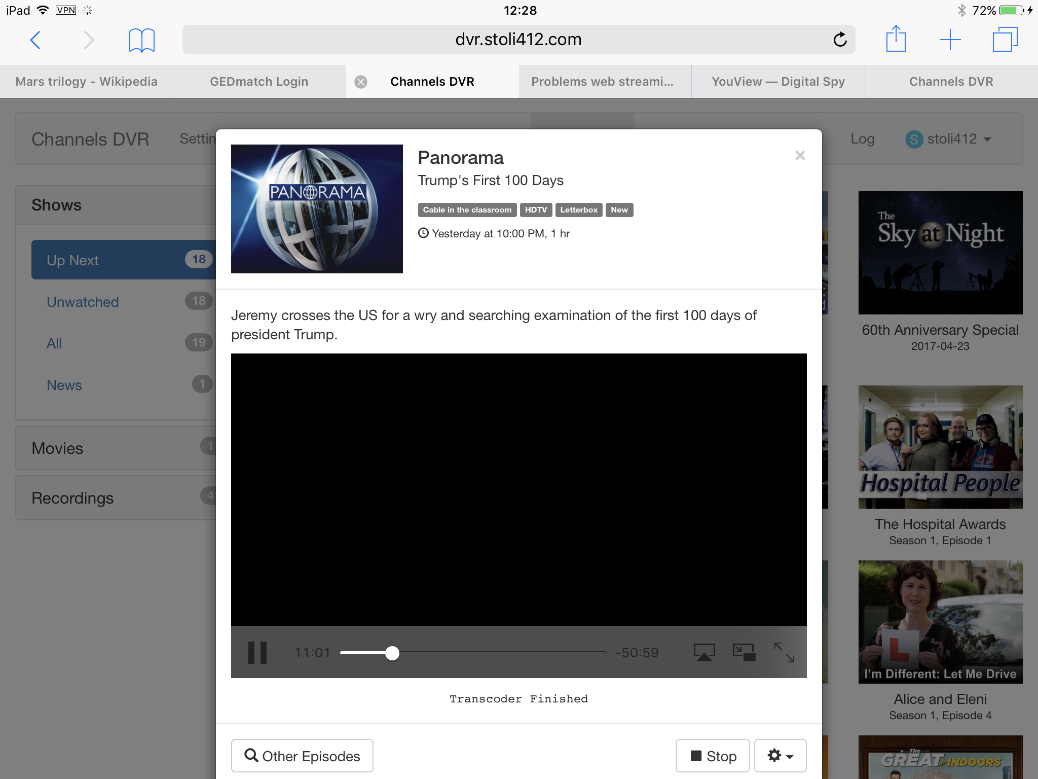

I’ve been away all weekend, so I’ve had good opportunity to further test web streaming. Live streaming has been working very well…I’ve had it running for over an hour with not a single problem. I’ve had trouble with recorded programmes though: they stream fine for about 10 minutes or so and then freeze. I have to stop and restart the stream, then they go for another 10 minutes, then freeze again. I’m on hotel wifi, but I don’t think bandwidth has been an issue since live streaming has been flawless, and I have the transcoder set to 480p/2Mbps. Not sure what the issue could be?
What does it say in the log and underneath the player when it freezes
I don't see anything telling in the log...a few errors during transcoding. At the bottom of the screen it says "Trancoder Finished". If I stop and restart, it picks up from where it froze and says "transcoder running" again. I'm wondering if it freezes at the point where its finished transcoding the entire file???
