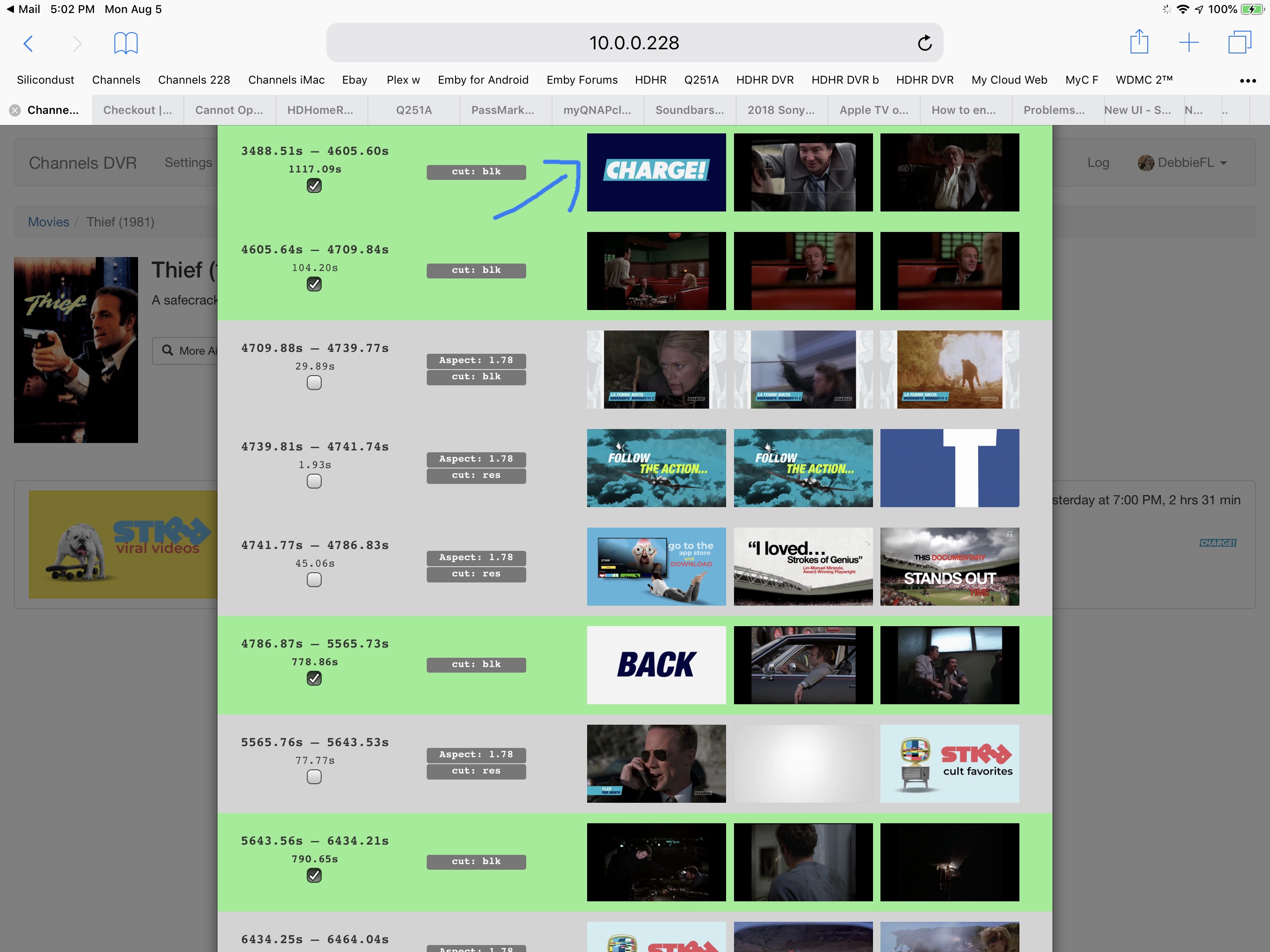

Even if you edit commercials, I cannot find an option to manually mark the commercial file for just that segment...as the edit currently allows only ALL of the 3 segment line or not. Much of the actual content still resides in the 2nd-3rd segment.
Suggest that @tmm1 or @maddox add the ability to only mark the 1st segment to add to commercial edit function while 2nd-3rd segment still remains marked as “non commercial”.

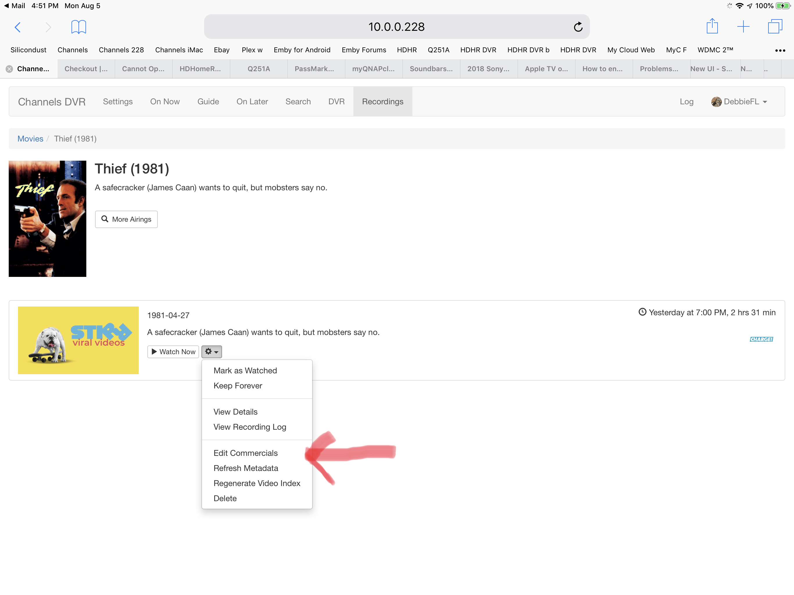

Debbie where do I edit Commercials?
Thanks
Only on Recorded files (either Movies or Shows) in Web UI:
Herb: Further example to my comment to @BrentScoles:
