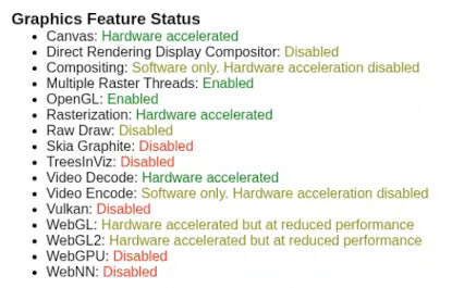

Thanks for the terrifc guide - I have this deployed in a ProxMox Container and it does work but I can't seem to get hardware encoding working, decode does work according to Chrome's GPU page.
For reference I am using a system with an i7-13700H. Encoding works for other containters (channels, scrypted & plex). Am I missing something or is it not possible? There is a lot of dated discussions saying it's not possible yet I see other people saying it works.
AFAIK it is not possible for chrome to use h/w encoding. Many people have tried but it does not work.
Thanks for clearing that up!
