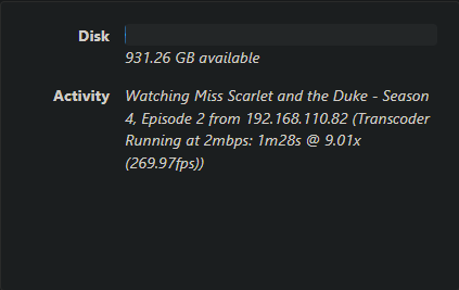

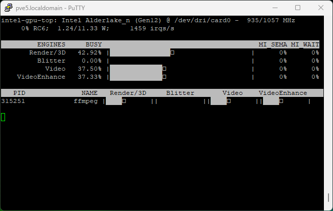

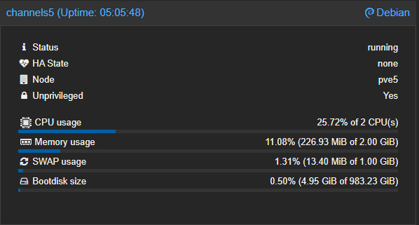

@slykens I've been testing a new ultra-compact NAS the last couple of days with Proxmox, with the idea of using it in conjunction with my existing Proxmox-based rackmount setup.
Anyway, your issue came to mind as something I could use both to test the new NAS, and attempt to duplicate your setup.
Nothing much to report so far, as I've been transcoding for about 4 hours now, and everything has been working as expected. This test host setup has a 12th gen i3 with 16GB of RAM and a 4TB NVMe drive.
The CDVR LXC I'm running has 2 vCPUs allocated, 2GB of RAM and 1TB of disk. It's running Proxmox 8.2.7, with /dev/dri/card0, /dev/dri/renderD128 and /dev/net/tun all passed through using the new option for that purpose in the LXC's Resources.
Here are a few screenshots of what I'm seeing with transcoding active:
screenshot-channels5_8089-2024_10_17-13_00_21
screenshot-pve5_localdomain_8006-2024_10_17-16_30_49
Screenshot 2024-10-17 120827
This is an unprivileged LXC, as I never run privileged, with the virtual channel I'm using for testing delivering 1080p content from a Samba share.
