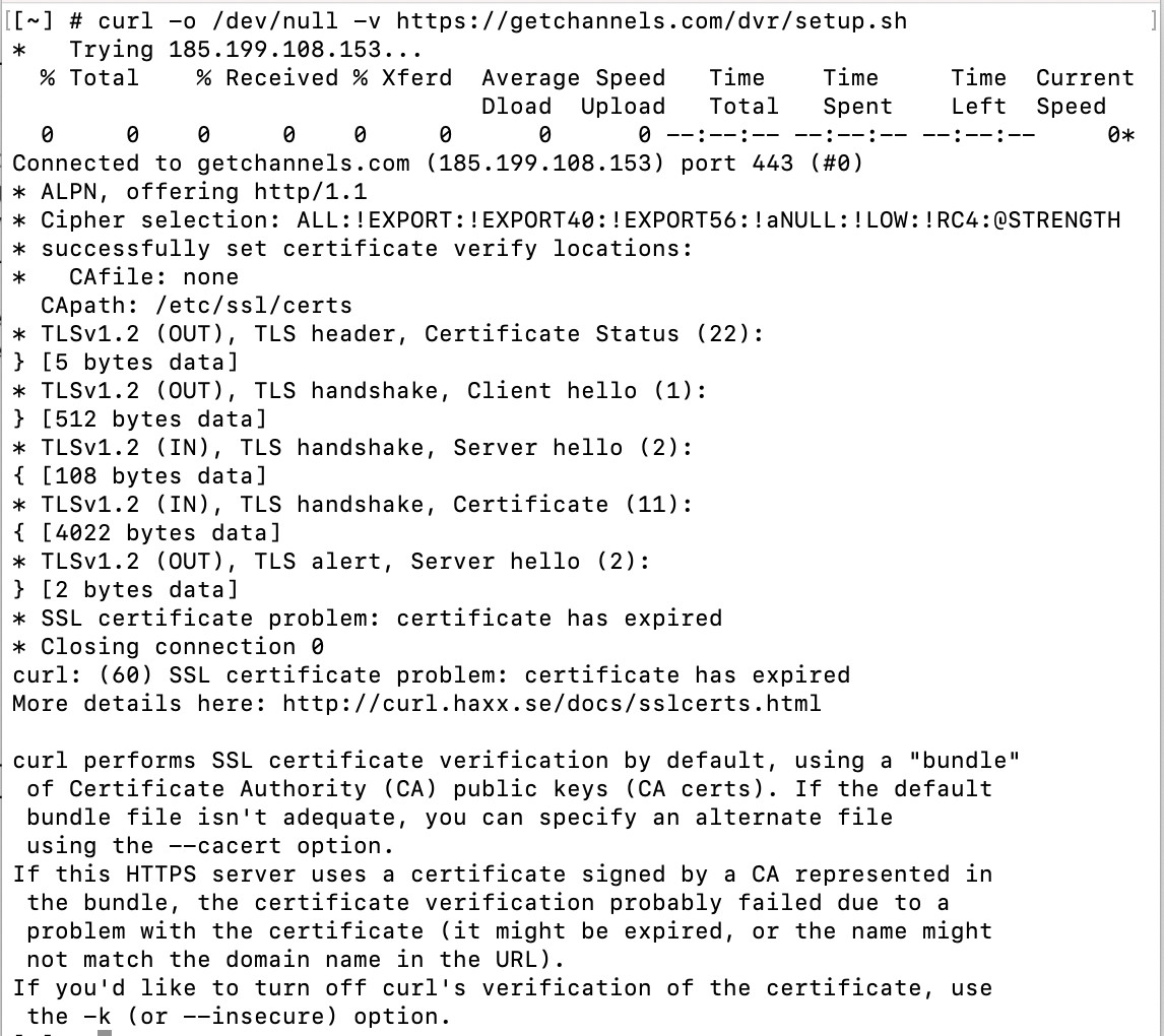

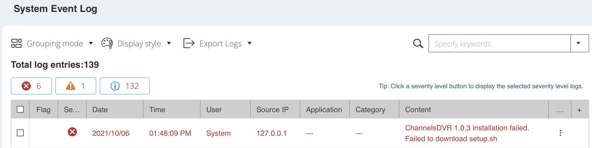

I have a QNAP TS-253D which I had to reinitialize. When I tried to install the Channels DVR package, I got the following error message:
ChannelsDVR 1.0.3 installation failed. Failed to download setup.sh

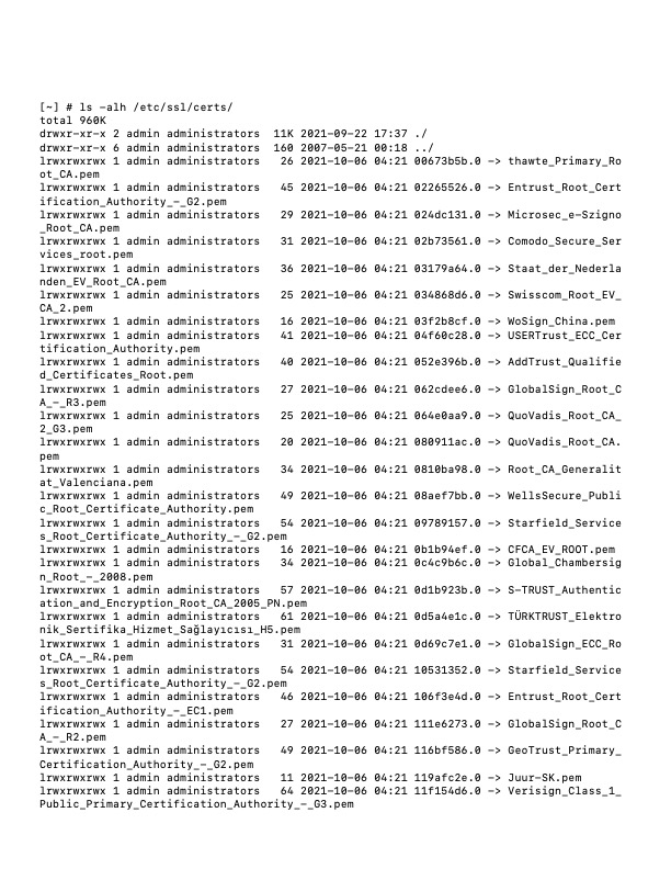

I am running version 4.5.4.1800 of QTS desktop firmware. I also get an error message indicating there is not a valid certificate for the package. There were some older posts related to this issue, but they were resolved with firmware updates. I am running a more current version of the firmware than those listed in the other posts. Can someone help me get this resolved?
