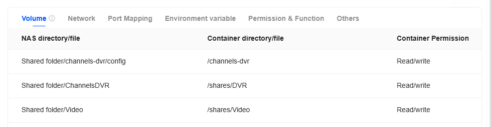

I have been through the migration docs, but am unclear on something. I currently have channels running in docker.
The following is the directory structure:
I am moving to an ubuntu install (no docker).
I have installed channels to /home/media
There is a directory created called /home/media/channels-dvr
It looks like my config and media are separated in the docker install....
Where do I put my Shared folder/ChannelsDVR (/shares/DVR)?
Should that sit along side the channels-dvr eg:
and
/home/media/ChannelsDVR
or does the contents of ChannelsDVR go under channels-dvr?
I know this is confusing... any help appreciated.
Thanks
Attach
The config doesn't need to be copied. Just move/attach the media folders and then restore backup from there
Sure, but usually you would mount an external drive under /mnt/ or /media somewhere. It doesn't matter where it is.
You shouldn't touch anything inside the install folder /home/media/channels-dvr
