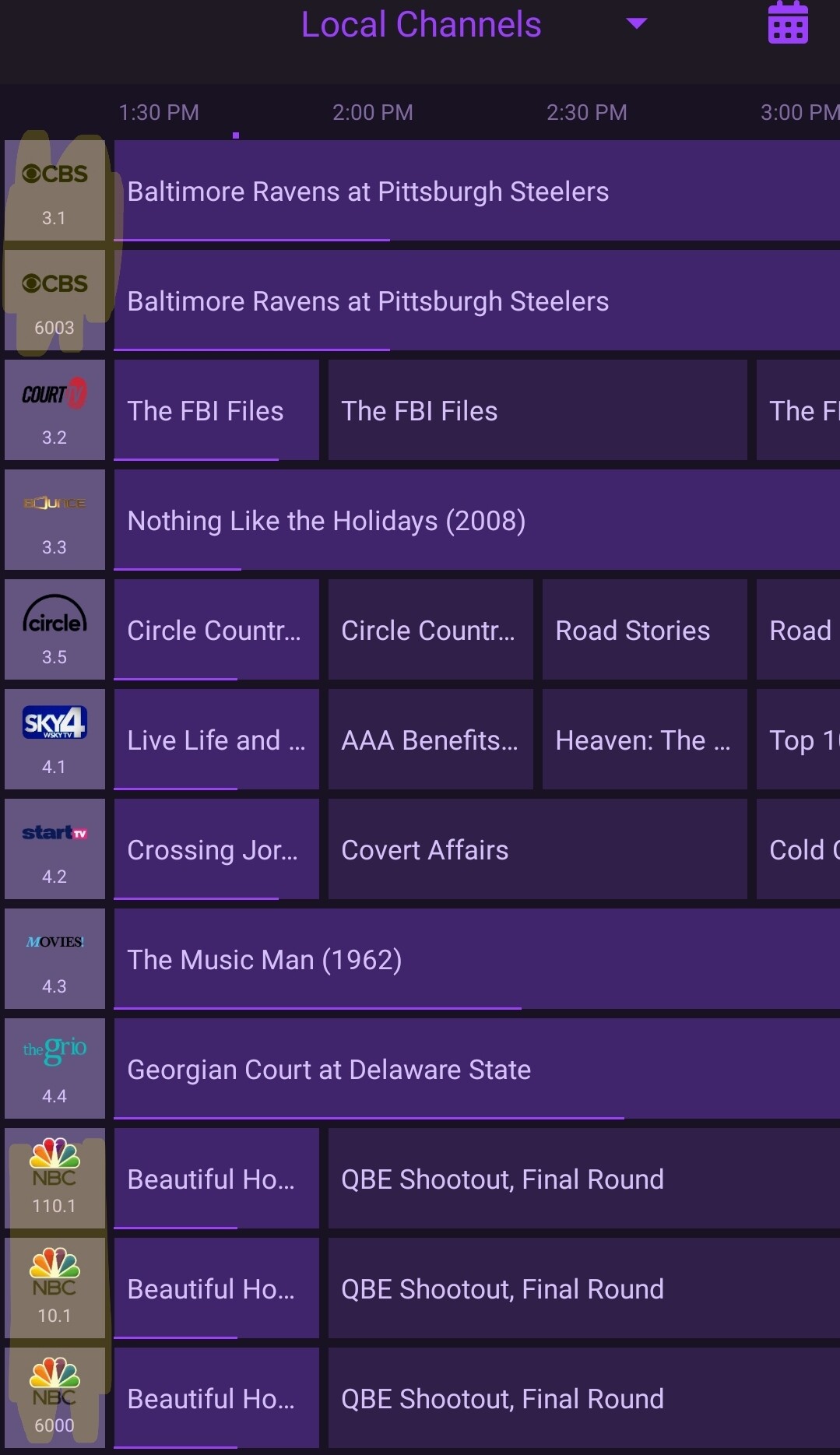

I don't have 2 markets but I do have local channels from different sources. Check out a custom channel guide view that I created that has CBS and NBC from different sources. It would be the same concept that you would have with 2 seperate markets on 2 different HDHR's. I have 3 HDHR'S and TVE as my sources. Take a look below to see what you can do

I too get OTA feeds from both Boston and Providence. If your antenna picks up both network stations, you will get both on your live display grid. If one comes in well and the other does not, you can disable the channel that doesn't work as well. You can also mark one a "Favorite" and the other just a regular channel. That way you can set your live display to only show favorites and not get a cluttered display with the same show appearing multiple times.
When you record something, only one station will be recorded, so your wife will not get confused by seeing duplicate recordings.
