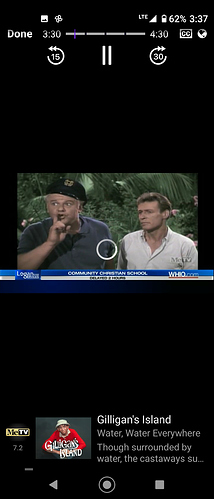

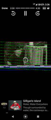

Everything runs great except hardware transcoding does not seen to work. I have tried it with both a hdhomerun connect and my original hdhomerun dual. Results are the same. Hardware transcoding either local or remote at any resolution other than original creates stream like this

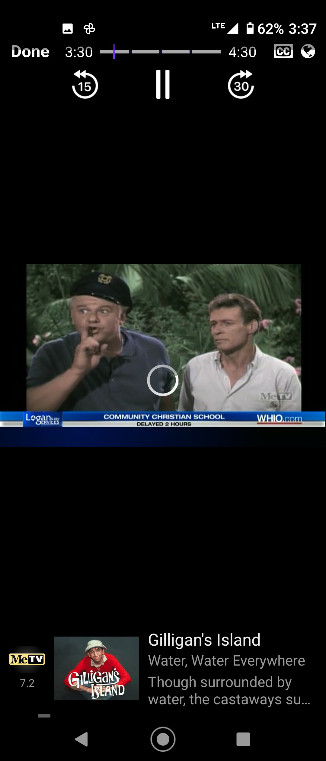

Software transcoding or Original looks perfect like Pic 2
