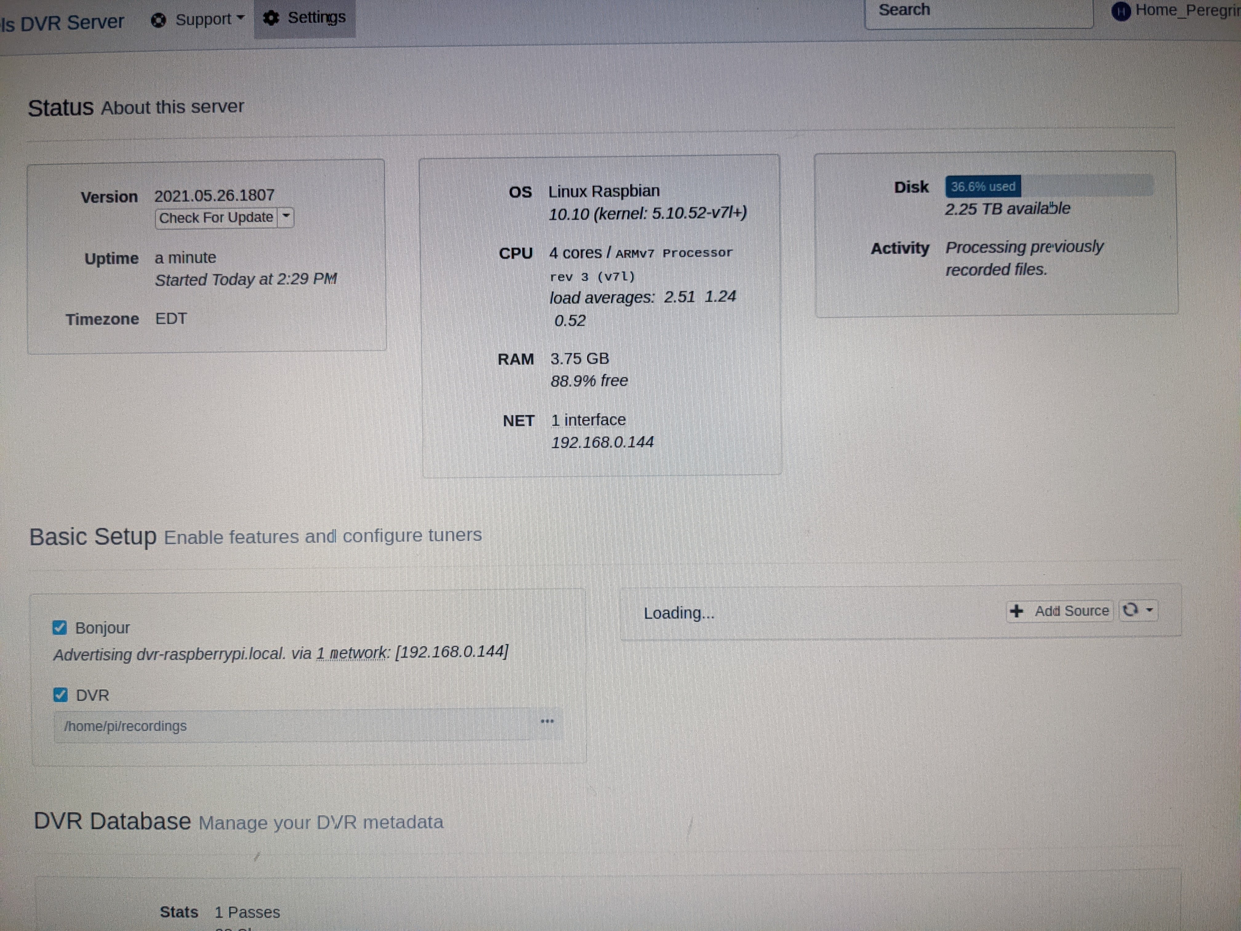

At 10:30pm last night, my Channels DVR server running on a Raspberry Pi 4 errored out. I don't know why. It had completely become unresponsive. Channels DVR server would not refresh. Reboot. Nothing.
I had reinstalled Channels DVR to the Raspberry Pi non-eventfully.
The issue now is that Channels DVR is hanging up when attempting to locate input video sources as indicated in the photo.

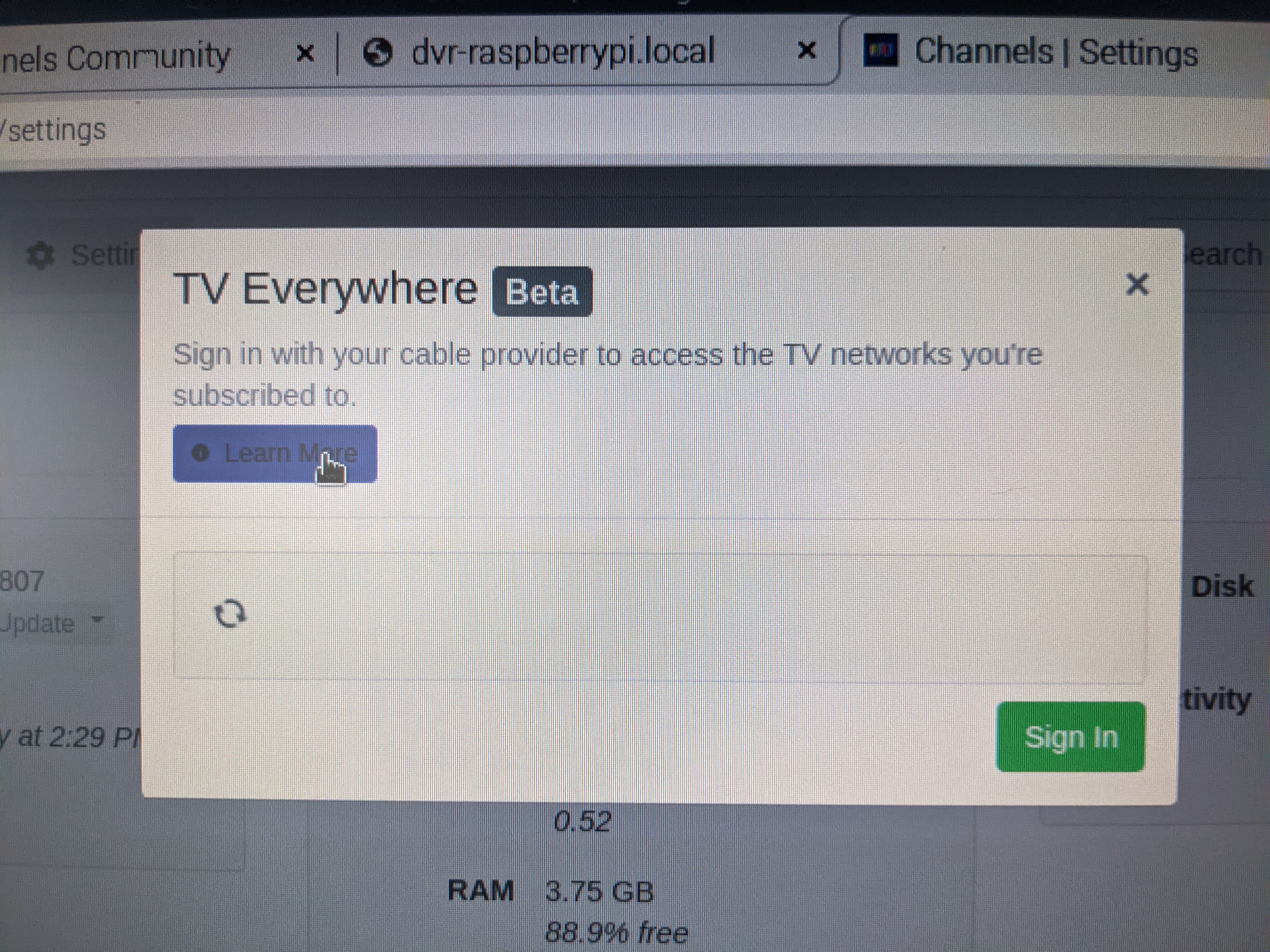

I can click on "Add Source". It will not auto detect HD Homerun tuners. I can manually enter an IP address for one of the HD Homerun tuners, but when I click "Add" the loading sources hang-up once again occurs. When attempting to add a TVE source, no options are available, the system just hangs.

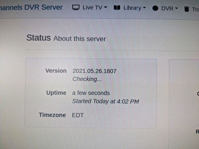

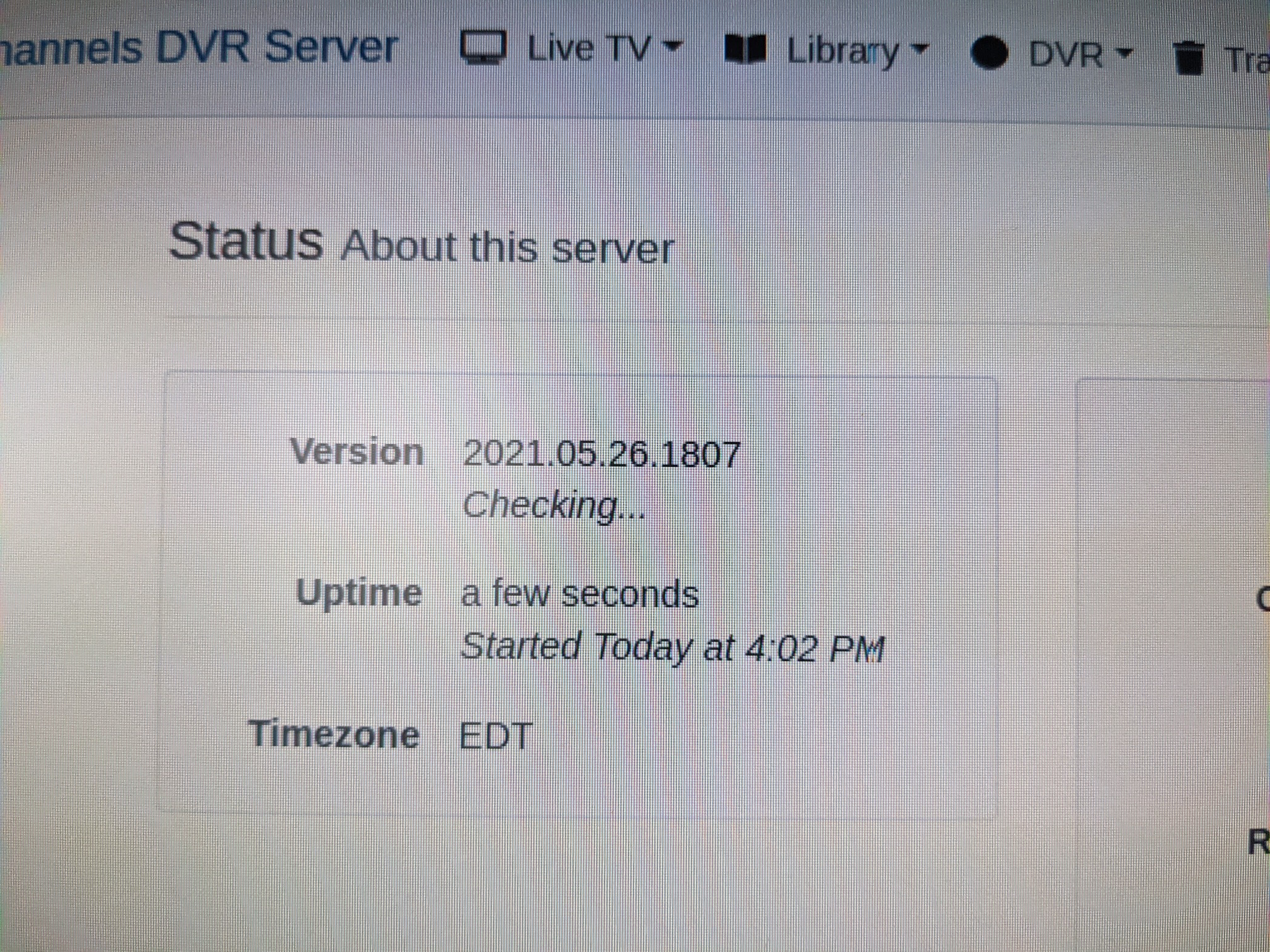

How would you suggest that I update? I ask because, look what else is hanging on this server, That's right. The check for update is checking and has been for 24 minutes.
Interesting aside, notice the server uptime. Every time the browser refreshes the time is updated to that browser refresh time.
Interesting aside
