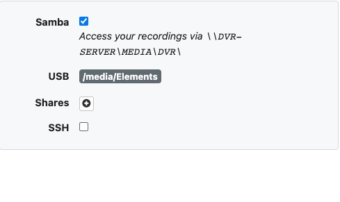

This is what I am seeing:

I believe I unmounted the drive--not sure what to do next...

It is interesting that I can see all of my recordings--I just do not see the usual capacity remaining information that I usually see.
You need to reboot so it's remounts. Do not unmount
Under Basic Setup, change /media/DVR to /media/Elements
Under DVR Database > Additional Storage, add /media/DVR
