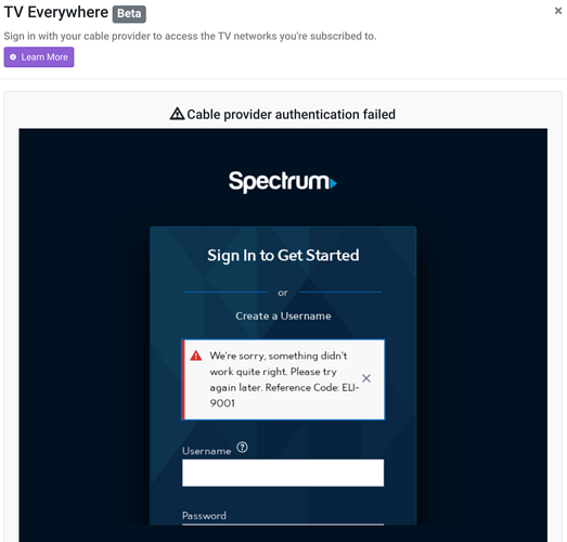

I tried several channels and none of them were working. Same error for each. So, I removed the source and attempted to add it back, as I have done in the past. It won't take my Spectrum credentials. I receive the attached authentication failure message, which indicates error ELI-9001:

I get the same message as my previous screen shot. "We're sorry something didn't work quite right please try again later reference code ELI-9001"
