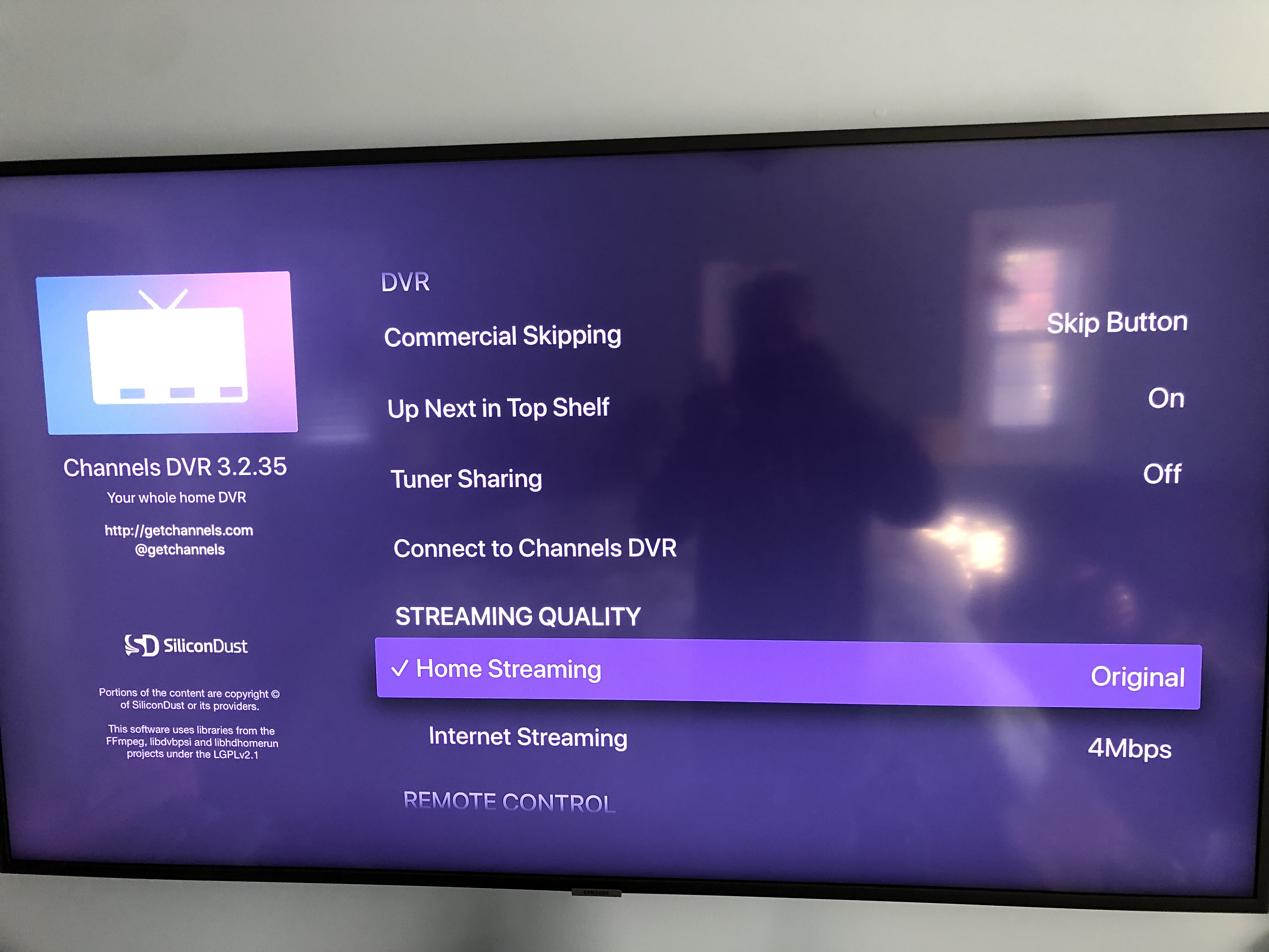

Yes the Apple TV is the client. Can you tell us what your quality settings are in the client, and if you have tuner sharing enabled?
Do I find that information in the app on the actual AppleTV? Would it be different on different AppleTV units? I have four AppleTVs that all have the Channels app on it.
Yes, within the settings area of the Apple TV app. And yes, the settings can be different on each one, they are not synched.

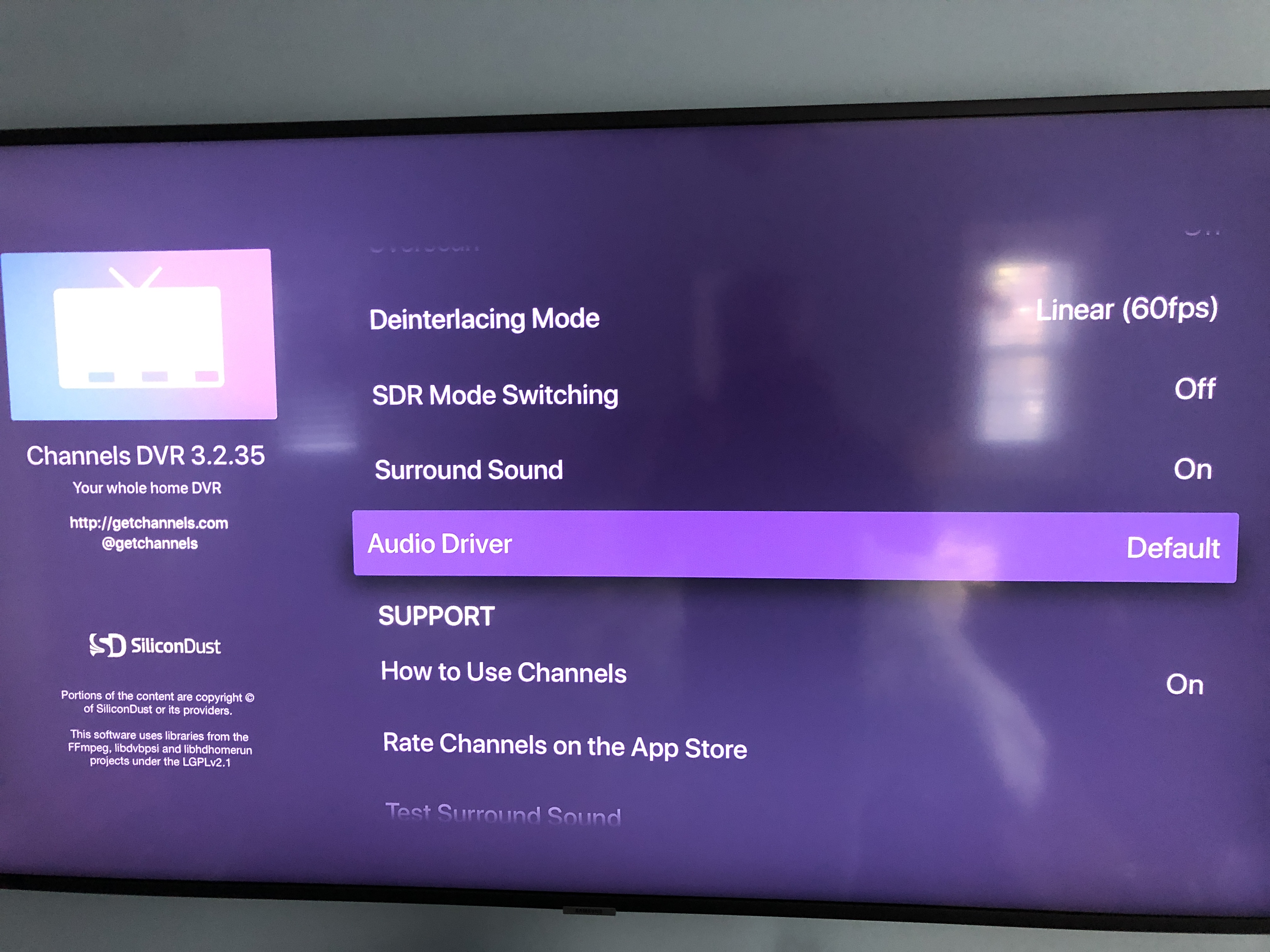

Thoughts on settings? Haven’t been able to test Ethernet yet.
settings are good. it will probably work when you test it with ethernet. Even if you only have a short ethernet cable, the ATV is small and easy to move somewhere just to do a test. If you don't own any ethernet cables to do a quick test, you could start troubleshooting your WiFi. Move the AP close to ATV, try a different channel, ensure you are connected on 5GHz, etc. I just suggested to try the ethernet first because then you will be able to identify the problem and save time in further troubleshooting.
To help you understand - with Tuner Sharing off (as you have), when you watch Live TV, the Apple TV establishes a direct connection with HDHomeRun, and the DVR server is not involved at all. With tuner sharing enabled, the DVR opens the connection to the HDHomeRun, then passes the data on to the client. This is what allows it to to “share”, as other clients or recordings using the same channel will be sent a copy of the same data. This conserves tuners, and I enable it on all my clients. It also requires the server to do some minimal buffering before the data is sent on to you. You could try enabling this option to see how it affects the behavior. It might help. It also might make it worse. As others have pointed out, this is most likely a network issue, so there is still value in connecting via Ethernet to confirm as well.
