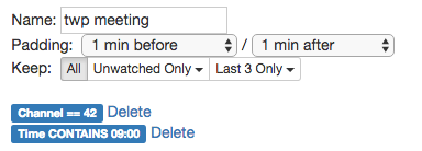

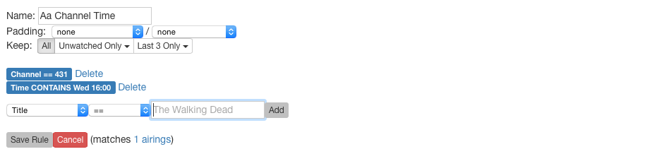

Try setting up a "New Advanced Pass" on Web UI: DVR...Passes...Gear Icon
I will try both ways at different times to see what happens. Love the idea of an advanced pass but I am not sure how the time will work.
Channels DVR did record the program at the time I selected in the guide. As stated, there is a bug that makes it looks like it will record at other times if the program title is the same.
I was not successful getting the advanced pass to record. It may because I left out the day of the week (i.e. used Time CONTAINS 09:00 rather than Time CONTAINS Tue 09:00). I am not sure of the proper format for Time. Issue can be closed. Thanks!
Using an advanced rule to record a specific time/channel is not recommended. Better to find the program in the guide and hit record on it.

You could use an advanced rule as noted above, but it’s simpler to just have three passes.
I use 3 different passes for recording 11 pm news: weekday, Sat & Sun. And the advanced pass for recording only on Thursday at 10:00 AM on specific channel
