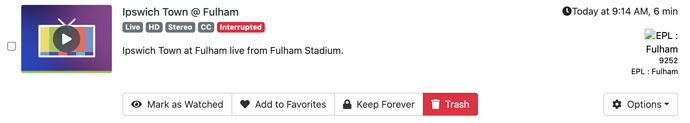

Recorded a soccer match that was 2hrs20mins long. I started the recording after the match started so missed the first 15mins or so. It recorded most of the game but close to the end, it was interrupted twice. Now when I go to watch the recording, it says that it's 6mins long in the recordings view. When I actually watch it, the time scrubber at the bottom shows 6mins. However, when the time scrubber gets to the end of the 6mins while playing, it just keeps playing and slides back a little bit. This repeats itself and eventually the full match plays.
In plex, it just plays the 6mins from the beginning and then stops.
Questions:
Why does it show it as 6 mins long but keeps playing?
The interruptions happened at the end of the recording. It looks like the 6mins might be related to the time between the first and second interruption of the recording. Is this correct? However, there were 13mins between the 2nd interruption and the end of the stream.

Note, in the DVR Management GUI, it also shows 6mins for the length:

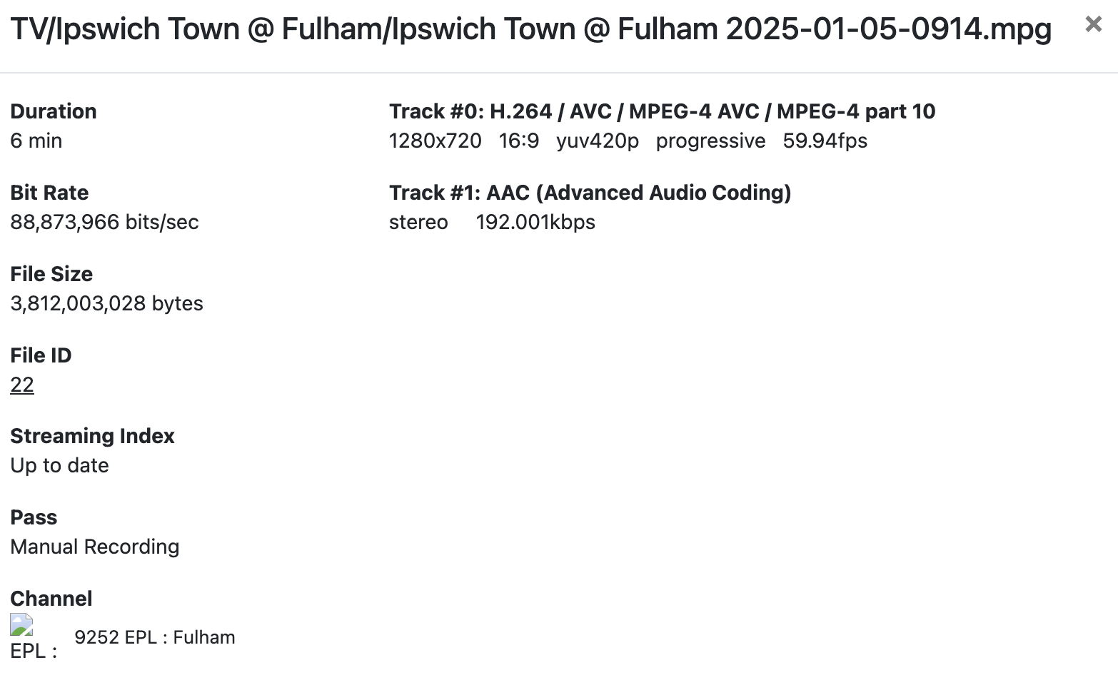

Recording details from DVR > Manage GUI:
Options > Fix Video Timestamps
That looks like an MPEG-TS stream source.
You might get better results using an HLS stream source, if they have it.
Thanks very much. That did indeed make the video now show to be 92:52 in length. However, if I play the recording and try to time scrub say 3/4 of the way through the video, it briefly shows a frame of the video then stops playing.
