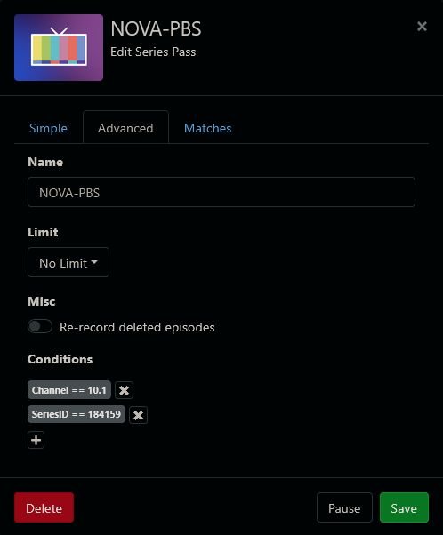

In passes, under "Advanced", you can specify which channel to use or which channel to exclude for a given pass.

If the guide shows the same NOVA episode airing at the same time on both channels, Channels DVR will record it from 10.2.
Either Favorite channel 10.1 and unfavorite channel 10.2, or change your pass to record from channel 10.1.

Sounds like you mean this.
The program guide data is correct for what's airing on channel 10.1
The program guide data is NOT correct for what's airing on channel 10.2
If that's the case, they may be mapped to the wrong station id or the guide provider has bad data.
