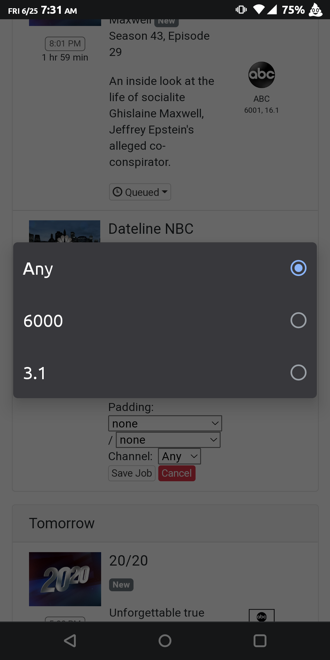

You can edit specific recordings not the pass to edit the channel recorded from if there are multiples
Or just put the quattro first in the tuner priority and block cw in the hdhr settings
How are you getting that option? I can not find it anywhere.
