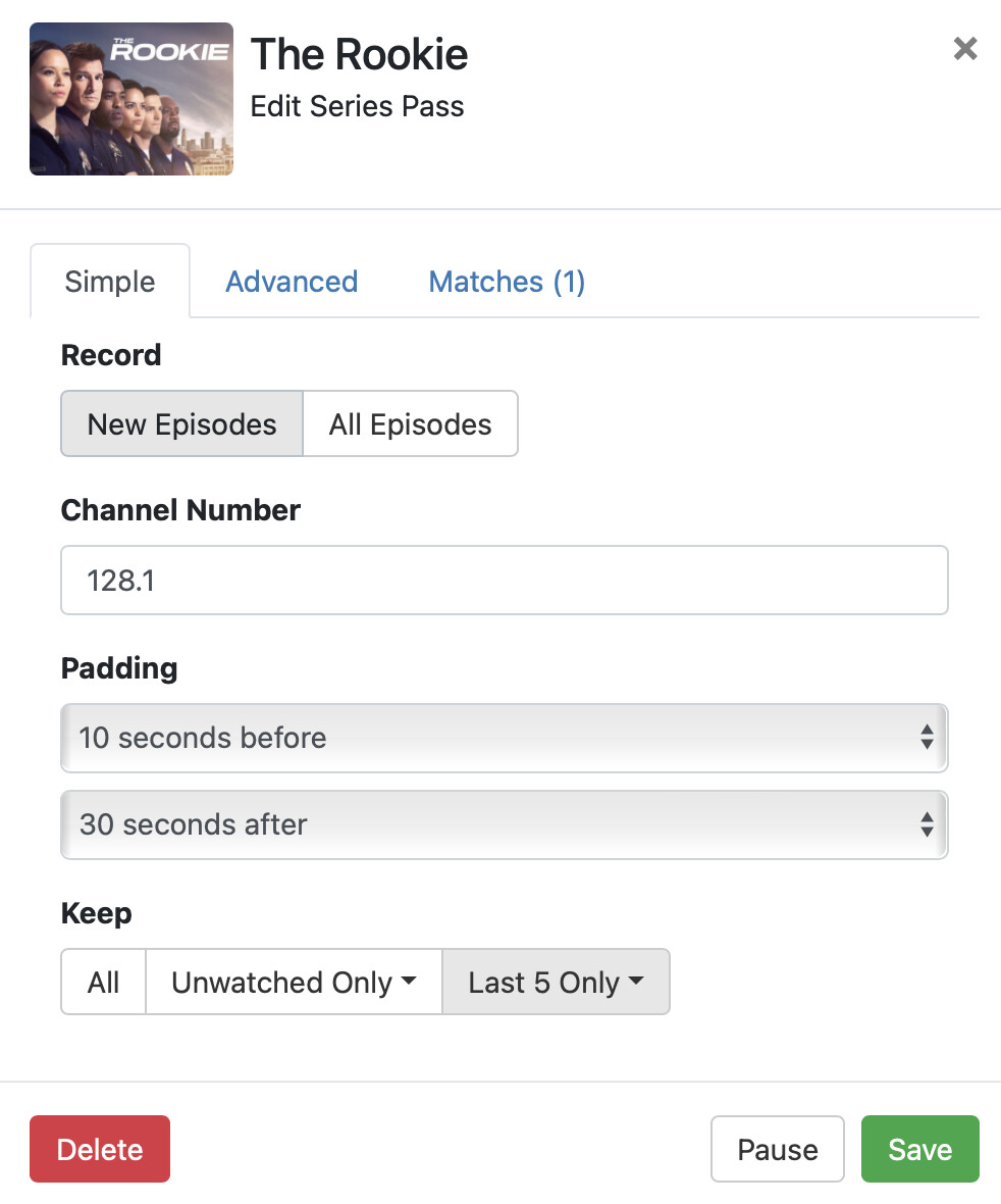

Not sure what you meant about posting the pass but here's a screenshot. I did have a channel number in the pass but I'm not sure how to create the pass without specifying a channel. I can't remember but usually I create them from clicking on the channel in the guide. If the ATC3 channel is available I'd like to use that one and that's the channel that is in the pass.

Remove the channel number from your pass and it will use the other channel automatically
For Example, my FOX ATSC 1 is weak so I want all fox to record in ATSC 3.0 only .. the only way is to include the channel number.
If you are trying to have the ASTC 3.0 signal be preferred but not limited to that, make the ATSC 3.0 your favorite channel for the specific channel, leave the ASTC 1.0 in the guide but not favorite, and then remove reference to the specific channel. If the ASTC 3.0 is available, it will record that channel, but if not will fall back to the ASTC 1.0 I believe.
