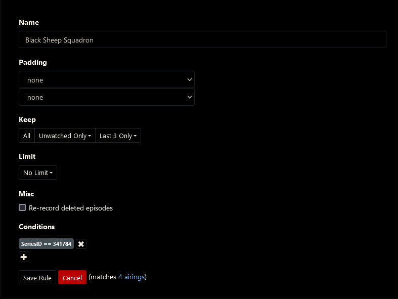

What does the pass look like if you look at the advanced view?
Is it using SeriesID == 341784
