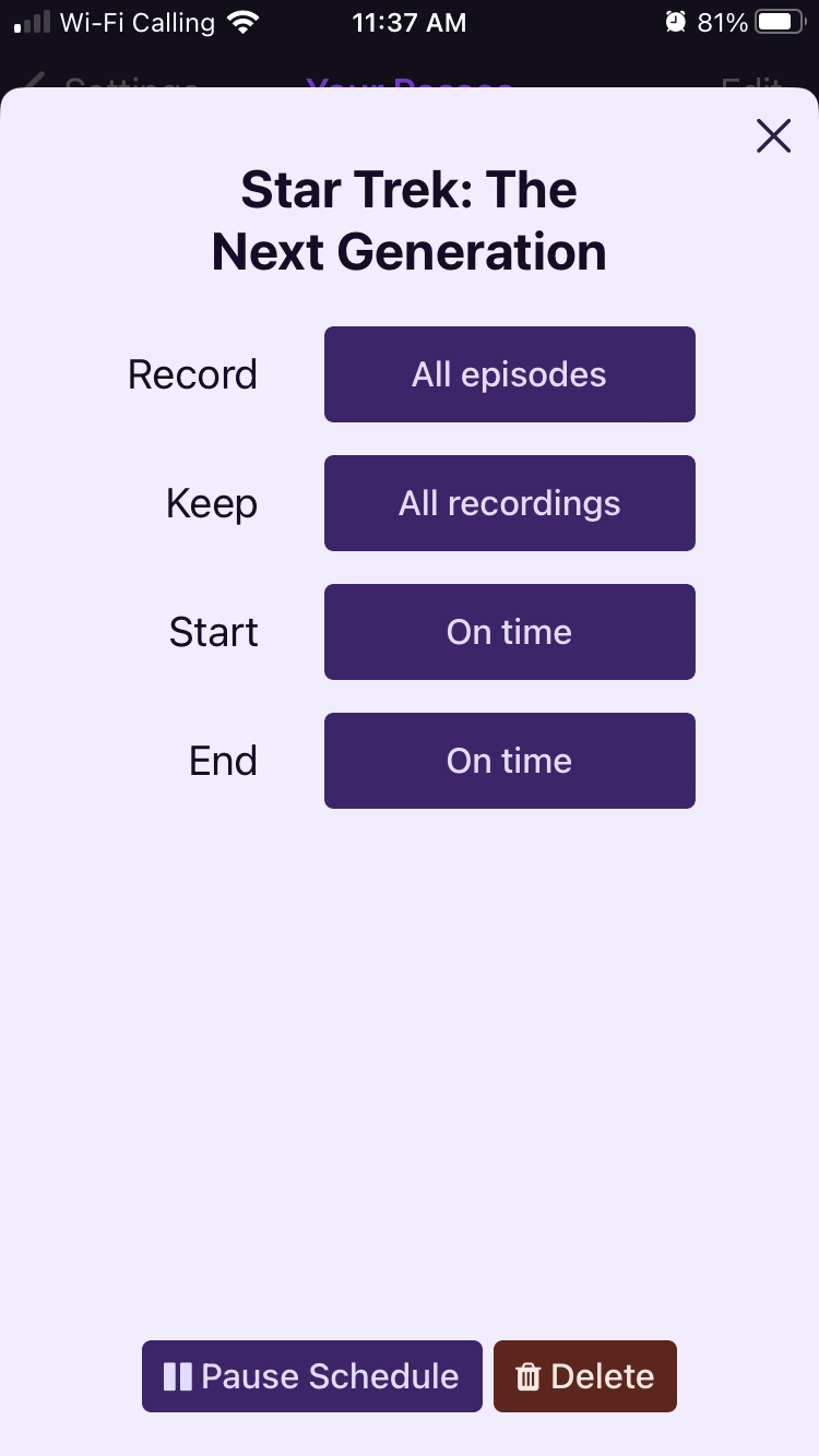

I have an OTA channel that often broadcasts a show I have a recording pass for, whose signal level seems to vary a lot. Sometimes it’s unwatchable but sometimes it’s good so I don’t really want to hide it. The same show airs on cable channels. Do I need to worry about channels recording and saving a very glitchy episode from the OTA channel when the signal was bad, blocking the recording of a better quality video from the cable channel in the future?
Channels DVR uses the source and channel its recording priority https://getchannels.com/docs/getting-started/faqs/subscription/#how-does-the-dvr-pick-which-tuner-to-use-to-make-a-recording dictates. If it can start recording from the glitchy OTA source, it will record it.
You can specify a channel number in your passes, or adjust source priorities and favorite channels to make Channels DVR record from the channels you want.
Looks like it's not surfaced in the iOS client.
I always setup and modify my passes from the DVR web admin UI.
